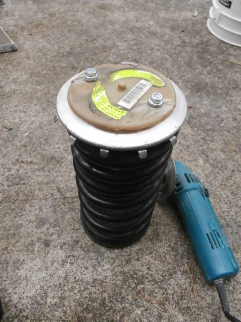

Doing a coil convert, has anyone tried cutting the top off an old air bag and making a spring cup/perch out of it?
just thought I'd check before wasting time cutting it and making a mess in my garage
Have you measured the top compared to the width of the spring yet? If it would cup it i'd say it could work, but you have to chop off the 2 raised portions on either side of the center nipple.

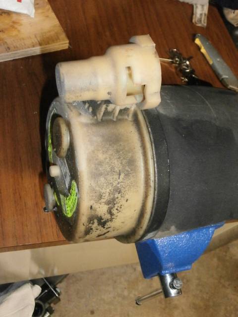

i'll go cut it up, and see what's inside :shifty:
---if it works as a top for the air spring, it should work as a top for a coil spring?

scalped....all dressed up and ready for the dance

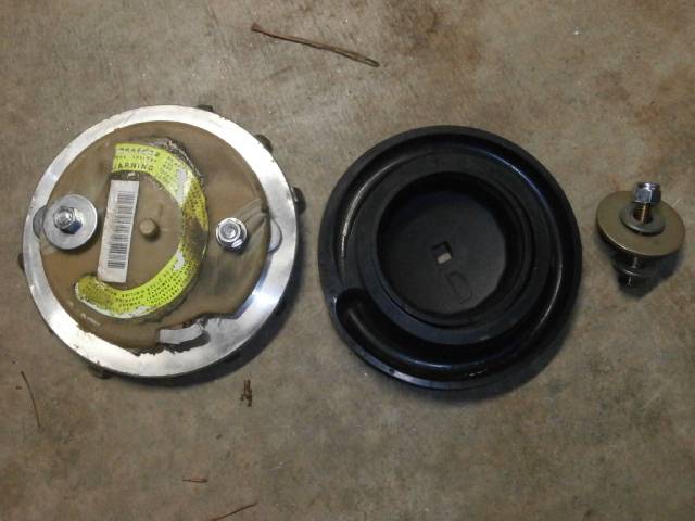

I cut off the two big buttons and used those as holes for fasteners, which will recess, so there will be full contact surface as original...no movey shakey...just need to clamp tight the retaining flanges from the snowflake around the isolator..

Upper perch.....added (1) 1.25'' fender washer atop (2) regular washers- that will twist/lock into the oem mounting plate
Lower perch:
Penzoil Code D poly synthetic oil filter socket wrench o.d. is .25"< isolator i.d.....2'' fender washer for the underside of the LCA with 3/8"" bolt nutted on top to snug and stay
cost @: $5 snowflake center cap; $6 hardware; oil filter socket $6

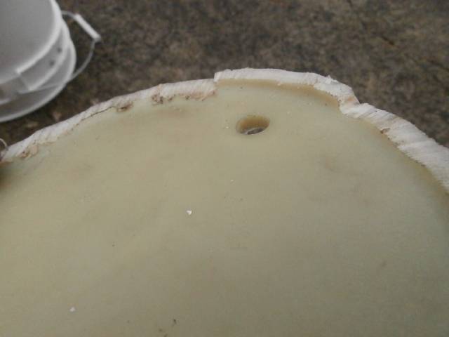

when cutting the other side, i left a little 'meat' adjacent the bolt hole to compensate for the curved center cap
