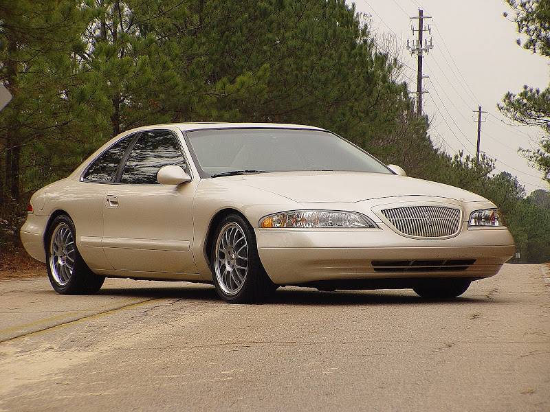

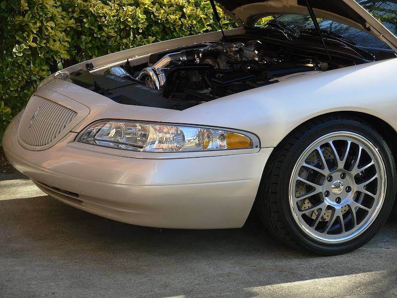

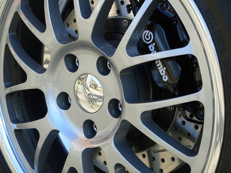

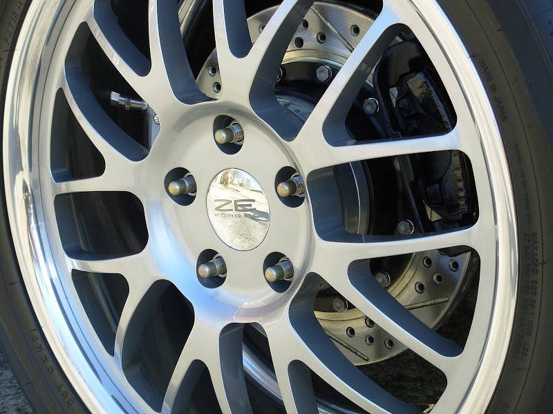

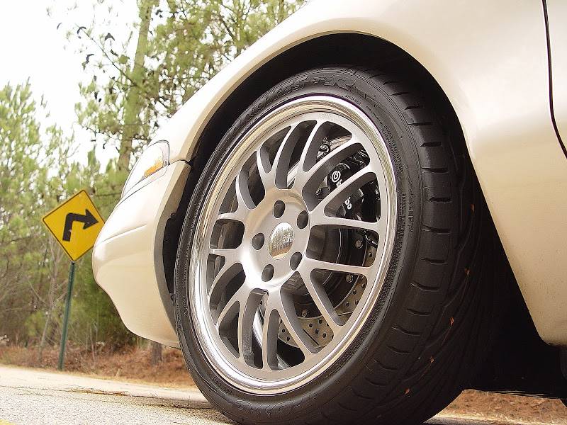

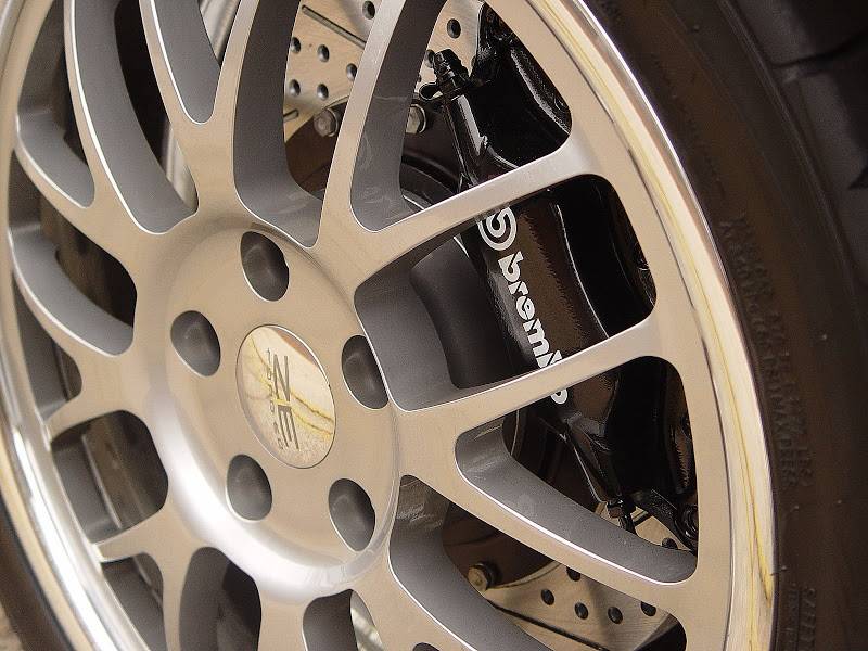

Here is the parts list for what you see in the pictures below. I replaced the rear calipers with stock bits from NAPA, and the front and rear wheel studs were replaced with hardened ARP racing studs.
IMHO, big brakes are worth every penny spent. There are clearance issues when going with Brembo's - even with 18's. I have also attached a link to the wheel specs on my Mark when going with Brembo's. Good luck! :)

M2300X Ford Racing/Brembo 13in 2000 Cobra R Front Brake Kit
136-2261002 Baer Eradispeed Extreme Plus 2 piece Front Brake Rotors for 1999-2004 Mustang Cobra
DP31031C EBC Brake Pads for 2000 Cobra R/Brembo Brakes
9904HABA Front Hub and Bearing Assembly for 1999-2004 Mustang Cobra
136-2262001 Baer Eradispeed Extreme Plus 2 piece Rear brake rotors for 1999-2004 Mustang Cobra
YR3Z1109AA Rear Hub for 1999-2004 Mustang Cobra IRS
E9DZ1215A Rear Wheel Bearing for 1999-2004 Mustang Cobra IRS
BR57B Rear brake pads for 1994-1998 Lincoln Mark VIII
Big Ed's Caliper Relocation Kit
Classic Tube SS Brake Line Kit
