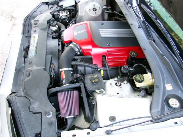

Other members have posted directions using dryer vent for a ram air tube to the air filter.

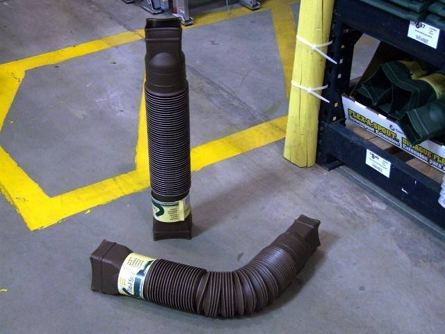

I found this product at Lowes and Home Depot, FLEX-A-SPOUT for about $8.50. It is used in conjunction with gutters and down spout. You can be extended and or bend it and it holds its shape; comes in brown, green and white. One end is 2”X3” and the other end is 3”X4” and extends up to 55”.

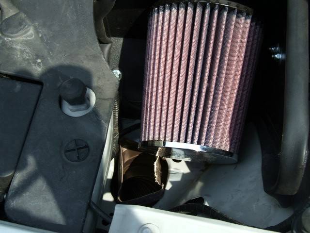

I used the 2”X3” end in the air box under the hood and cut off the 3”X4” put it next to the left fog lamp. It fits very snug and did not require any fasteners.
I need to pretty it up but it works well.

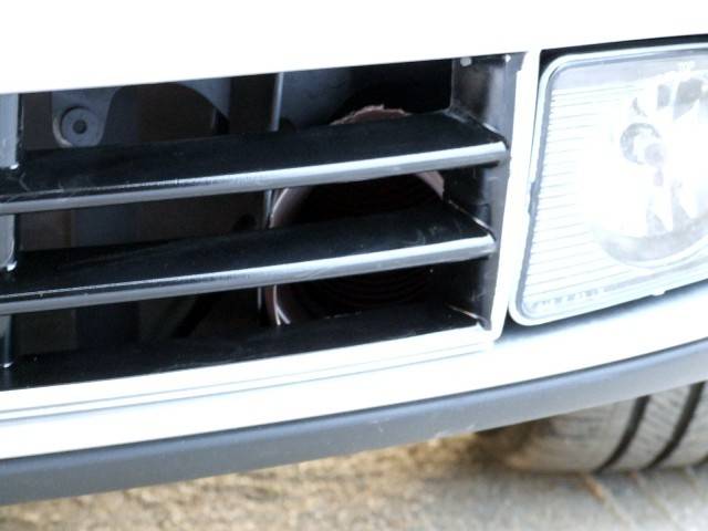

I tried to take a photo of it in the lower grille but to dark to show.
It is wedged in four places very tight and is not going anywhere.
It is so tight that I had to grab hold with pliers from the top and pull very hard to get it in place. It does not budge.

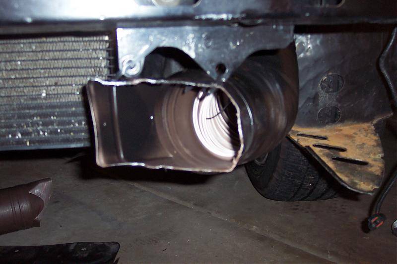

thats exactly what i did except with dryer vent tubing. yours is probably a smarter idea since it wont rust and im not sure if mine would. i took it out a few weeks ago but will probably use your idea to do it again.
up top i just punched holes in it and zip tied it to the little holes around the larger one where the spout comes out. you might want to put some metal mesh if you havent already over the opening or youll get a buildup of rocks and small debris that can channel straight up to the filter.
I'm still getting use to the K&N CAI so I can't tell. The more cool air I can get to the air filter the better. For under $9 and about 20 min. labor it is a small investment.
I did this same thing on my 02 LS about 2 years ago. I use my XCAL2 to monitor air intake temperature a lot and this mod really does not do much unless you have a BIG scoop at the front of the car to shove air in.
Another recommendation on this would be to use a razor and cut off the square ends off the tubing, thats a bottleneck. You would get more airflow that way. You have the right idea. Good work!

i used those little mesh sheets you use to fill in holes in walls and put that over the end of mine to keep debris out and not have just an empty hole look in your lower grille
