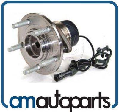

Is this all I need or do I need something else with it
Thats all you need. I would recommend doing both sides. Its very easy to change yourself, sometimes after you remove the bolts it doesnt want to come out but a little persuasion with a hammer does the trick. I jacked up my car and grabbed the top and bottom of the wheel, shook it back and forth, and noticed a little play in the bearing.
