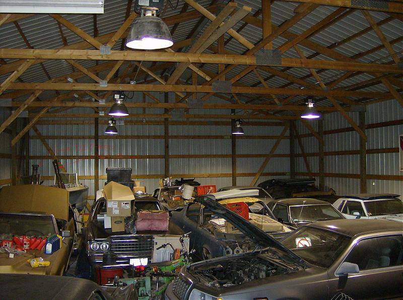

Positive the stock cat-back is 2" from my 02 V8. From what I read all are the same. Many on here say 2.25"...I disagreed with that so last time I was up north were my storage barn is that has my old system along with a 02 T-Bird system in it, I double checked. I was right. Both are 2"
The pipes before the cat-back connection appear to be slightly larger probably 2.25", but thats not what I think you need to know.
THey are leaning against my boat in the left corner of the barn.:)

Hey Jason, your barn called me last night. It asked if I could tell you to clean it the hell up. ;) Jesus, if I didn't know any better I would accuse you of running a chop shop by the looks of that picture. :p

HAHA classic, "I'll get to that later." What a collection though.
