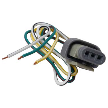

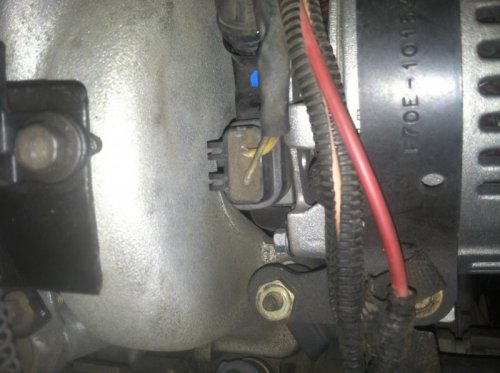

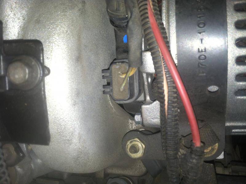

Whoa wait a minute I thought the first gens have a three wire plug and 2nd are 2 wire plug. I was going to give my cousin my old one for his first gen 95 and the plug was 3 wire on his... So it'll still work?
You have many right on here saying they have a gen2 alt on there gen1 including me. So...
2 wire? no...
technically the center wire terminates in the harness. only the outside two wires go anywhere. but all three are there.
but they both fit in both generations. they just changed up the case design a little.
i also have a 2nd gen alt in my 93. been there for years.
they all have this connector. both generations.

remember when i said the three wire plug only uses the outside two wires? ford just didn't add that center wire. they must have dropped it from the harness at some point.
its still the same basic plug.
oh i see. yep.
Gotcha and that's why I was tripping out off it.
