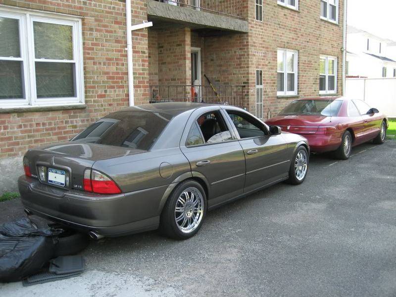

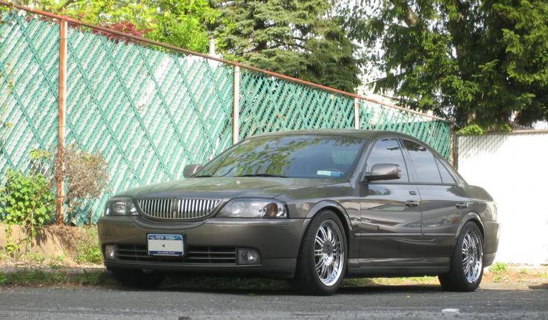

I didn't have much of a gap with my 18s..
Its neither tire nor wheel, its the springs. When upgrading wheel sizes you should match the tire size accordingly to get the same over all diameter as stock.
I forgot how good your car looked with 18's! WOW!!! What tires do you have on them? You have the Eibach springs as well right?
After I put the Eibach springs on my car it got rid of the nasty tire gap. I just want a good flow of the car, know what I mean!
245/45-18 Nankang tires. 245/40s woulda been a bit better for the rears since they rubbed when I had people in the car.
