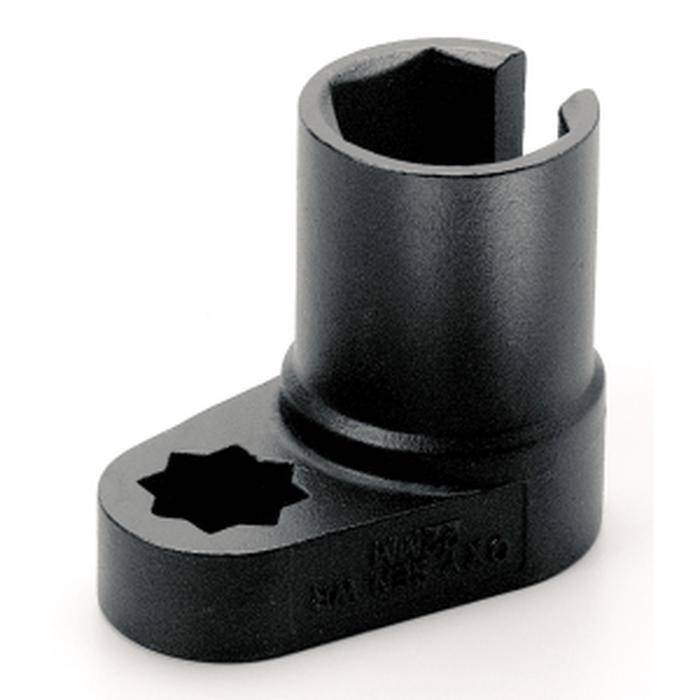

whats size wrench or anything of the sort do i need to take it off. or do i even need a wrench the sensor right before the first set of cats

Oxygen sensor replacement
You can get a special deep socket with a slot on the side for the sensor wires to slip through at your local parts store.

turn your car on to warm it up for like 2 minutes, the sensors will come off easier
