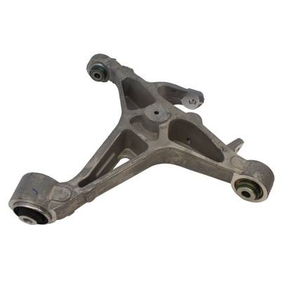

The one it shows me looks like this which looks like it's for something else

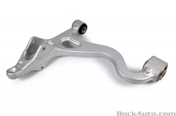

But mine looks like the one with the front offset bushing mount that says 16mm which looks like this
I went originally to parts.ford.com but they do not show my part for my vin which I guess is because it's discontinued. The dealers don't either.
I tried a couple others. oemfordpartsdirect and bluespringsfordparts Both of those show the wrong arm for my car.
So it's looking like from what I can see that the 14mm arm is a different design than the 16mm? Which makes me even more confused since RockAuto shows both 14 and 16 arms that have the front offset bushing mount that looks like mine.

That other arm in your post above looks like the rear lower control arm.
My bad. You're right Joe. I did not notice I had to go all the way down for the front suspension.
But I'm still confused because while I was just back there I checked both the 2001 and 2003 in addition to my 2002 and all three list the same number for the lower arm but starting with a 6 instead of a 2 like the site that says mine is a 16mm. On an irrelevant note, for some reason the page for 2003 didn't seem to show any rear suspension pieces. (shrug)
