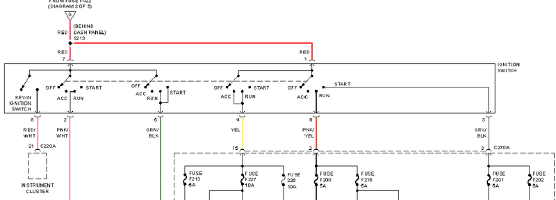

Hey everyone, so I've been looking into a push to start system for my LS and came across a few. Can anyone provide me an accurate ignition cylinder wiring diagram for the 00 v6 along with how to remove the cylinder itself?
Also as a side question, will I lose the auto seat adjustment after converting to a push to start setup? Or is that system tied into the accessory switch at the cylinder? I noticed the auto adjustment kicks into play as soon as I put the key in, regardless if I turn the key in any position.
This shows all you need to know. Add a relay powered by the run circuit to ground the red/white wire to retain the easy entry/exit feature.
