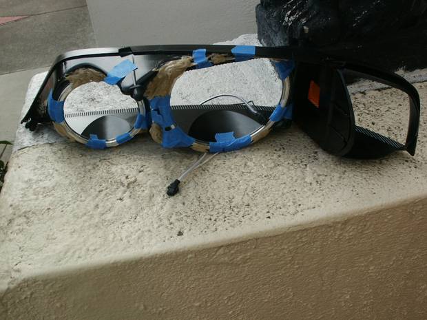

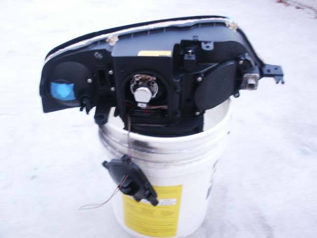

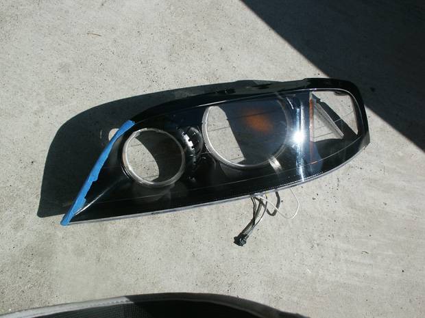

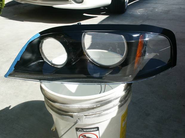

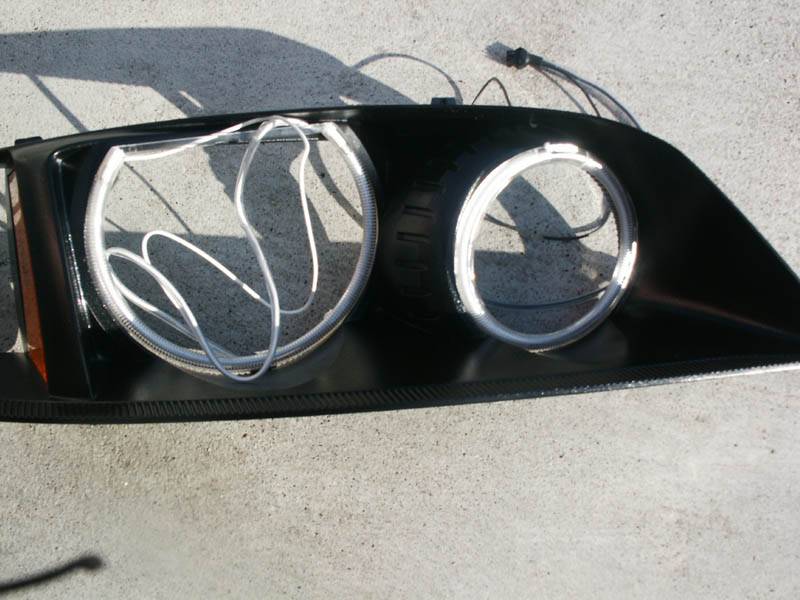

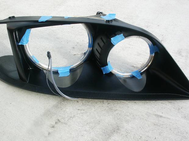

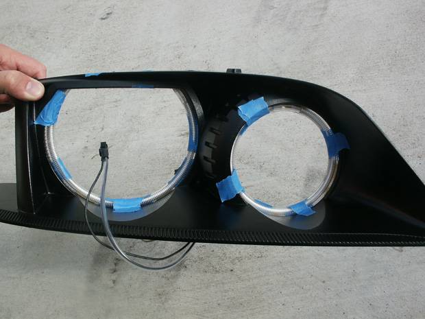

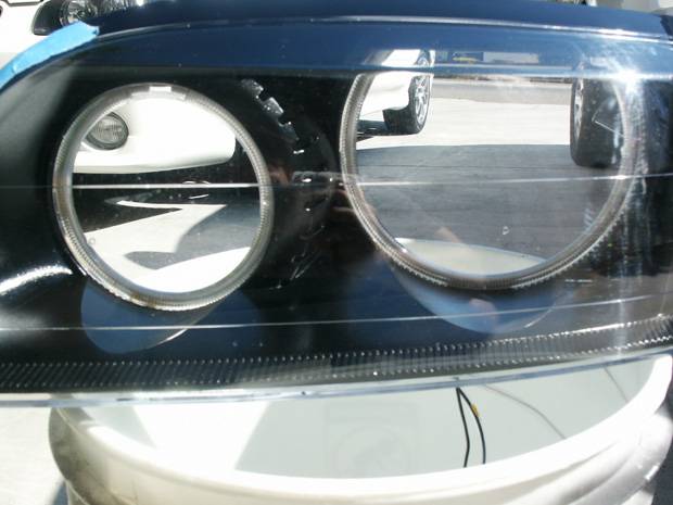

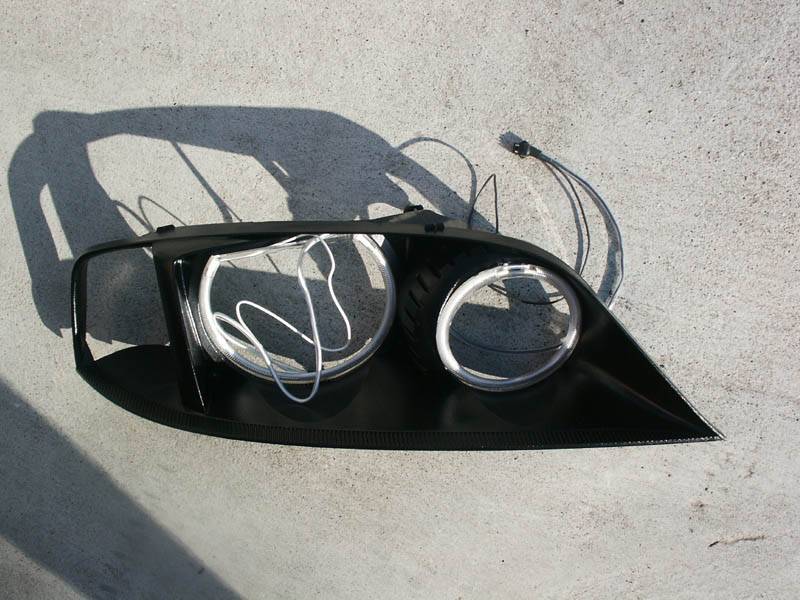

Finally found a guy who said he would have no problem taking apart the 03+ Head light to install angel eyes. Here are some pics on the progress sofar...i will keep you guys updated.

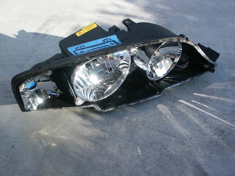

How did he get them apart? Looks like it's in 3 pieces.
He cut the headlight in two. You can see where it is cut at along the seam. That is the only way to get the headlights apart. Notice the two different ring sizes. I'm curious to see how it looks with the rings of two different sizes. Also, sealing the headlights back is going to be interesting to see too. And to beat all that is a set of HID headlights too!
The company working on them is lightwurkz.net. We contacted them some time ago so we'll see how this goes.
IMO, the smaller one should be the same partial circle as the low beam. Having a big 70% halo and a small full circle might look a little strange. Sealing the assembly back up shouldn't be too difficult if you take your time and use some good waterproof epoxy. Not only will it seal it, but it will hold it together well. Wont be the prettiest job, but it will get the job done regardless. Done it many times with headlight and taillight projects. Get the dual tube epoxy coined "plastic bonder". Works wonderfully and dries semi clear.
I sure you have But if youll notice the low beam isnt a full circle anyway.So its following the same lines on the headlight. I cant wait to see the finished product!

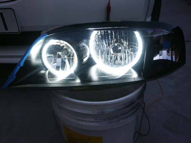

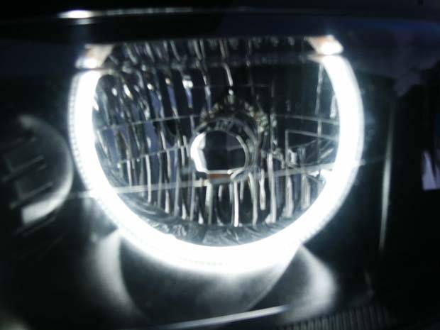

DONE!! Looks Great, hopefully everything is dried painted and I can expect them Teusday!!
SWEET!! Better get a write up going for the tech section on here. Cant wait to see them on the car!
Damn that :q:q:q:q looks clean, great work man i reallt like what i see take your time and do it right. can't wait to upgrade to the 03+ headlights
Looks great. This is groundbreaking news, actually. The smaller ring looks very nice/doesn't look odd at all. Hopefully there wont be any moisture issues.

It wasn't meant as either. I was just pointing out the fact that you'll have a set of factory HID's and angel eyes. There seems to have been a tremendous amount of work done to those headlights. I bet he's got about 15 hours in those. It looks like a quality job. If he used Umnitza's stuff then you won't have any problems with the kit. That's why I sell Matt's products on my website. He's been there and done that and has the best ballasts, rings and equipment for angel eyes. I'm interested to see what they look like on your car.

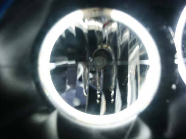

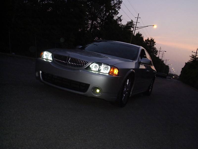

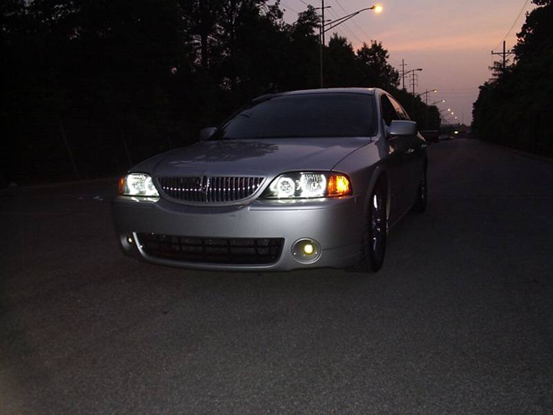

crap camera.. i'll get better pics this weekend after i detail the car.. and borrow a batter camera
