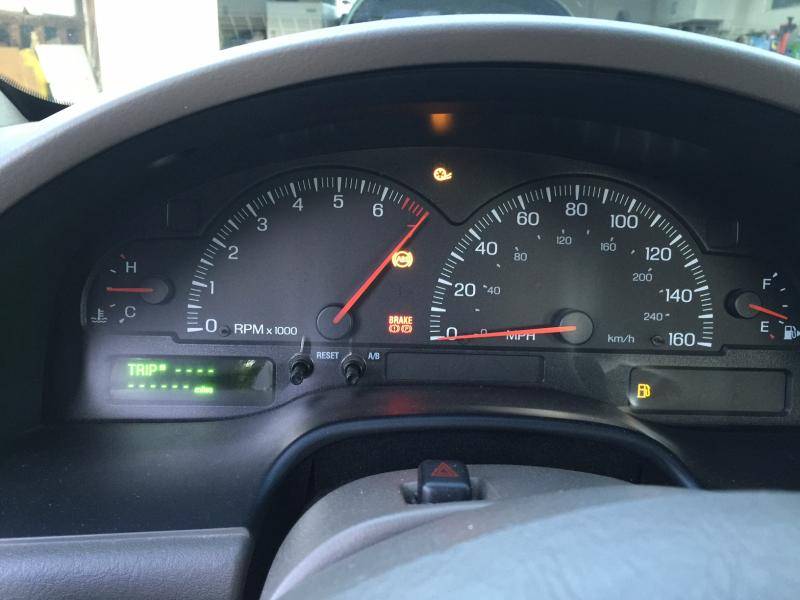

Well, decided to get the LS out today since the weather here has been so nice. Got it out and let it idle in the driveway for a few minutes and noticed it sounded like it might have a slight misfire. It wouldn’t surprise me, as the coils are all original so I decided to hook it up to the scan tool to see if it would pick up anything. I’ve got a fairly decent Launch scan tool that will pick up just about anything. With the car running I plugged in the scan tool and immediately the “P” on the gear indicator changed to the not so lucky “E” for about 5 seconds. It then went away all together and the instrument panel went to this. Notice how the odometer was blanked out. The headlights also came on, even though the switch was set to off. Shut the car off, then turned the ignition back on and everything was normal. Not sure if this is anything to be concerned about or if it was just a momentary glitch in the computer when I plugged in the scan tool. I am aware of the symptoms/causes of the “E” on the gear indicator and I will say that the car has a harsh shift into reverse every now and again, but that’s about it. The "E" has never shown up until now. After it ran for a while, the misfire seemed to go away. The car is a 2000 V-6. Would love any input on this. Thanks in advance.

Battery is about a year and a half old. It's a vented Ford battery and it's always on a trickle charger when it sits for long periods of time. Could the battery already be going bad? Never has any starting trouble.
From my experience with FORScan and a generic OBDII>bluetooth scanner, it looks like the scanner tried to connect with the cluster? Does your scanner pick up B___ and C___ codes? Or just "all" P___ codes? If I connect to the cluster and start giving commands (lights on, needles move, display prove-out, etc), the odo blanks out like that. Upon disconnecting, the headlights flash and the needles do a full sweep.

I'm not sure if the scanner picks up B and C codes. If I recall correctly, I can turn on various accessories (fan, lights, etc.) with that scanner. The scanner came from a German car repair shop after they upgraded to a newer platform, but it works great for all the American makes as well. It's never done this before so I'm guessing it's just a random glitch. Thanks!

Good to know! Thanks for that info. Also found out the scanner does pick up B and C codes but the only code that showed up was U1262 SCP(J1850) Communications Bus Fault. Has anyone seen this code before? I'll probably clear it and see if it comes back. Thanks again!
Yes, quite a bit. As long as it isn't persistent, it shouldn't be a problem.
