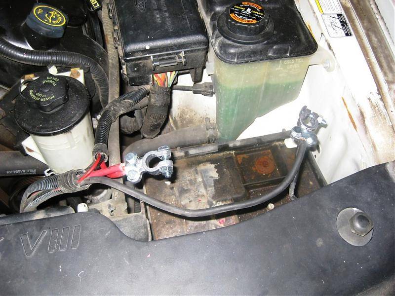

My car was giving me a few issues, slow cranking, etc....
Replacing the battery clamps fixed the issues up in a big way!
damn lawnmower/motorcycle band clamps!
those things are absolute CRAP!
I already have decent clamps. Just like those above actually.
