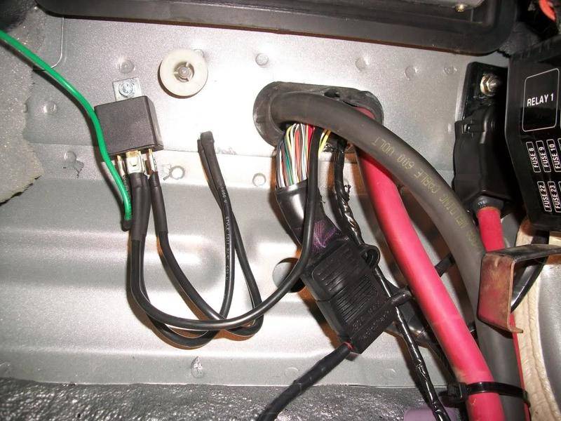

No problem. I ran the power wire for my electric cooling fan conversion to the passenger fenderwell on the inside of the car where the positive battery cable bulkhead fitting is located. The factory power wire is the one all the way to the right in this pic.
Hmm I unbolted my fuse and took the bottom compartment off, there's a lot of colored wires. Which one is the 12v to tap into?? And also, when I do find the 12v, how can I tap multiple wires to it? My hid relay-fuse, and angel eyes.

I know what bolt you are talking about as I thought that's the one people on here were talking about. That sucker is not coming out lol I tried and stopped short of breaking it.
On the other hand you could do what I did, got the idea from Alax, and just run them into your fuse box.
Big ass bolt on the driver's side of the fuse box under a little flap is the primary power feed to the box. 8ga wire running to it. It has a phillips drive, but use a hex drive on it.
Otherwise, all the leads that don't have fuses are hot, so you can use those "add a circuit" doo-dads. I wouldn't recommend it, because that's a horribly poor connection. But if you can't figure out how to get the primary feed disconnected and a solid connection under it, then that's your next step.
