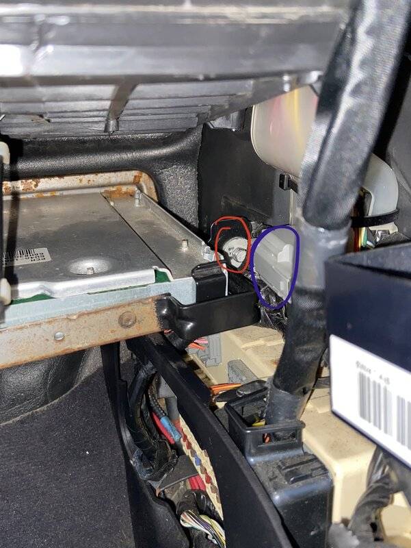

so i finially got a code for my park brake module its C1988 it says " Yellow fault warning Lamp indicator Circuit Failure" this should be whats causing service park brake right. also how do i go about fixing it i cant find anything online
i saw that i could try disconnecting the EPB module and that it’s by the left wheel well in the trunk but i cannot find it at all i looked on the right as well
It is indeed on the left (driver's side) wall of the trunk at the back, and somewhat difficult to see and get to. Anyway, disconnecting it isn't going to help.
While it could be something else, it is almost certainly your parking brake switch in the floor console. The plastic hinges get brittle and break. I was able to fashion metal ones that worked okay. Good luck finding a working switch anywhere now...

hey i feel like an idiot i found out the KAM fuse wasn’t even in the car it’s still running rough but all the engine codes went away and electrical stuff works i think it’s probably the pcm or cats
