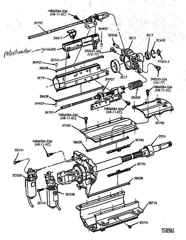

As to the steering wheel not moving up and down this is a very common issue - If you gently lift up on the steering wheel and try the switch it should move up or down. Do not bang or yank, as there is a small plastic (nylon?) ball that holds this all together and if it breaks you are in deep poo.
If this works then the part that is defective is the Potentiometer $30 from Lincoln, but is has recently been discontinued. MAx might be able to locate one, but not sure.
thanks for the info, ill give that a try....
im glad i resited the urg to bang on it when it wouldnt move down
