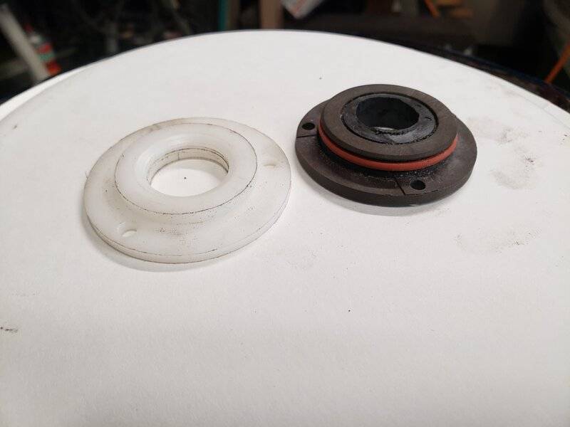

As for the rings I dont think anyone is making them but you in my pic I show a adapter ring and one made from an old bulb. Made items with just a hack saw and dremall

Hate to say it, but I dont think anyone is making the adapters any more. I looked hi n low for them last year when I was forced to make the adapters up my self like slowMK suggests. I did however create a how to article that if you copy it and take your old bulbs to someone with a lathe, they might be able to bang out a pair of adapter rings out of your old bulbs. Anyone with 101 machining skill should do these up for a small fee. The article gives you pretty much what all is entailed to get low beams up and running again.
