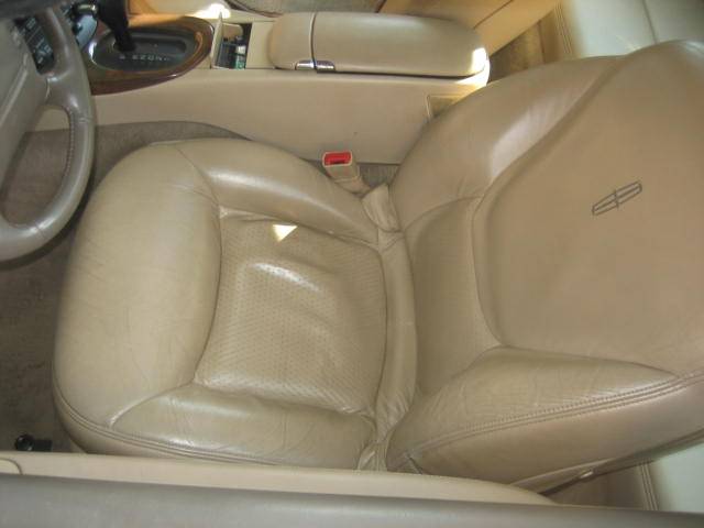

Well here she is. Breif history: Got her last september with 125k on it. Paid 3k. Needed a blend door actuator, Driverside seat control was cracked and hanging, Seized drivers side strut,chrome wheels were horribly corroded, sunroof acsess panel was broken, floormats, j and strut rod bushings, rear rotors and some other things.
Got the bj and srb's done from a friend for $120 parts included.

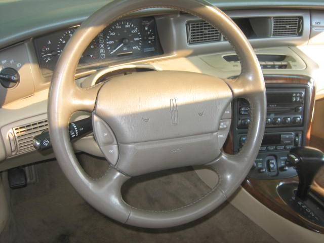

Used abs compound to fix the seat control panel, $3.

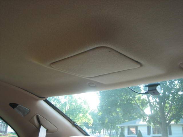

Rtv sealent for the moonroof panel.

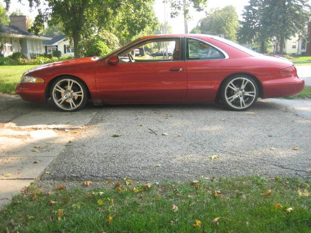

I also replaced all 4 corners with used arnott struts/bags for $300. Painted them the same color as the car to.New shocks to.

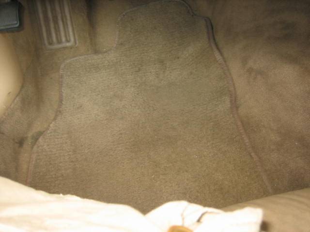

Got new aftermarket floormats specificly for the mark. Almost a perfect match color wise.

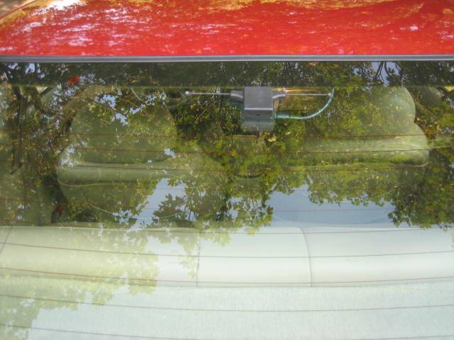

Rear cell phone antenna was broke so i put on a diff one. Looks alot better.

Sensor lowered it alot.

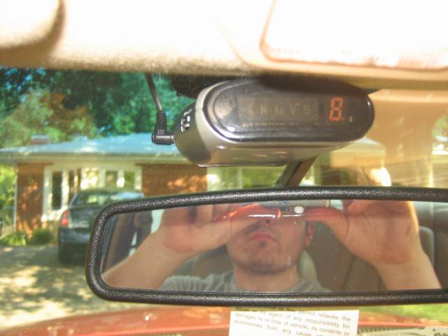

Hardwired a radar detector.

disconnected the telescoping wheel for both in/out, up down motion. in/out didn't work. Opened it up and manualy adjusted the in/out/up/down. Left it alone

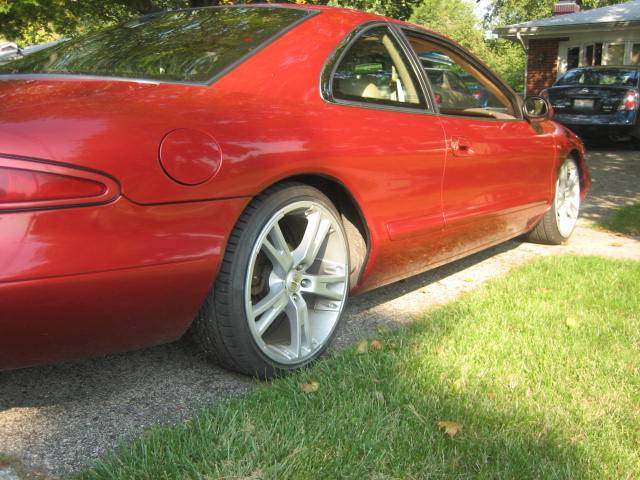

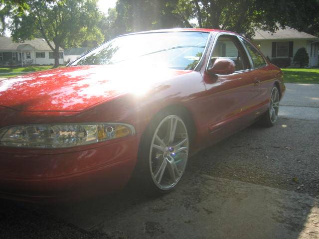

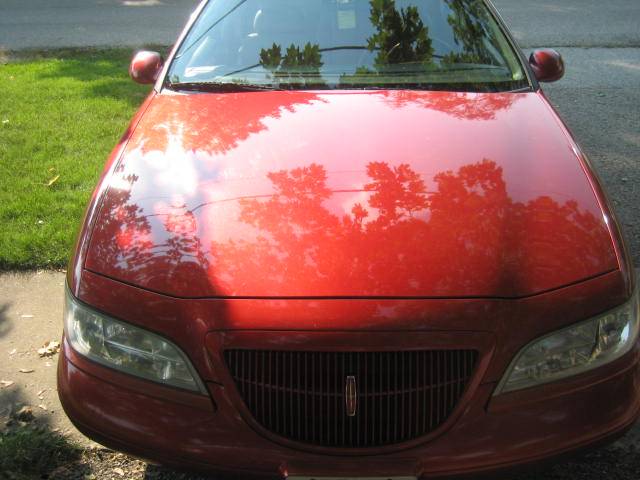

Looks real good think it could use a bit wider tires tho, or a size taller.
i hear ya. but they were what it came with . If i had my choice it would've been a 245/45/19 but it was a good deal. The tires alone cost him $650. I prob wont ever get to getting new tires, those wheels are just to dam heavy.
great looking car. love the jag wheels. You need to buy some bigger tires though. The ride has to suck with those rubber band tires.
Those aren't Jag wheels, they're the same ones I have - Mille Miglia EV-R. And they look better on my car ;)
It's not to bad. But my 98 grand marquis w/ 255/35/20 rode a bit better, prob cuase it has body on frame.
did you put in the new compressor? cause the front is low like my car.
I have a like new compressor, got documentation. It has 15K on it - took it off cuz of the coil conversion a while back. Let me know if anyones interested.
For all of them, I dont need them and shipping will be included in the price.
its sensor lowered alot and thats at parked height. These wheels/tires are about 1.5" shorter then the stock set.
