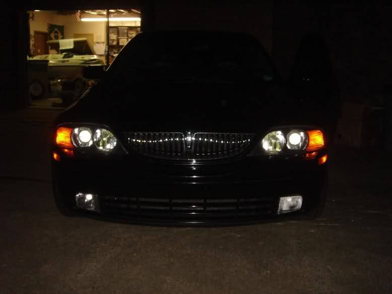

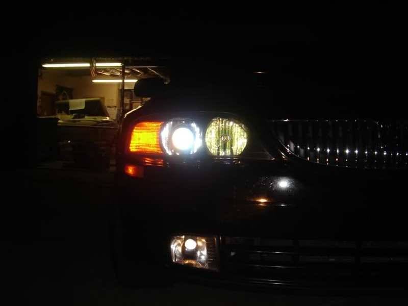

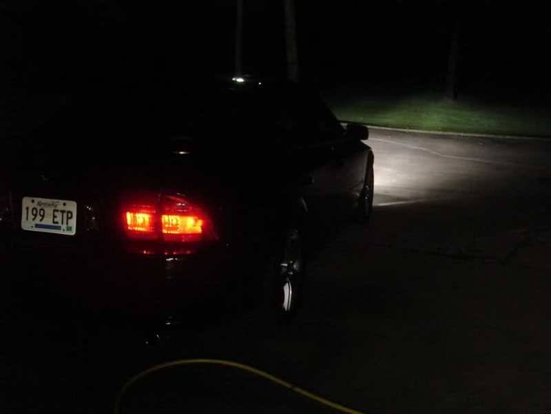

I ran an HID "kit" inside the stock foglight housings for a few days before I decided I wanted to do something different. The output of the kit was pretty poor compared to high amount of glare it put out. I had a set of 350Z projectors laying around so I put them in the LS foglight housings. The bulbs in the 350Z's are D2R 4300K ran at 35 watts.
I am pretty pleased with the final result. Virtually zero glare and a lot more light. It looks oem too. Let me know what you think:cool:

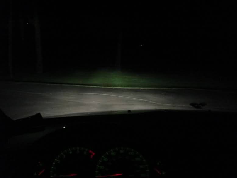

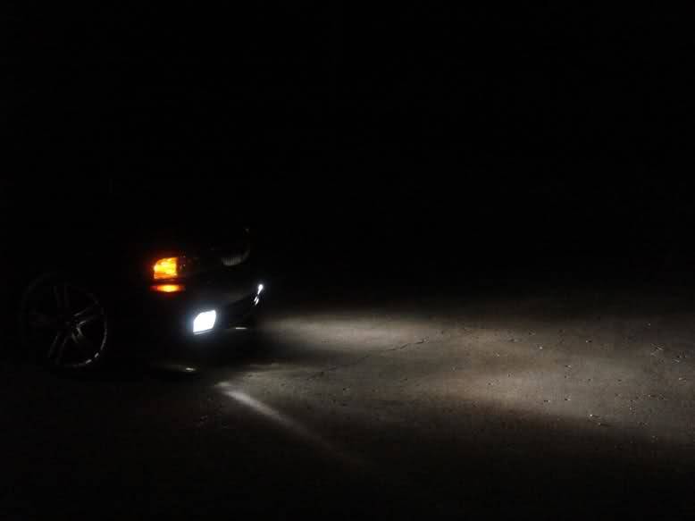

The picture above is the light output from foglights:D :D

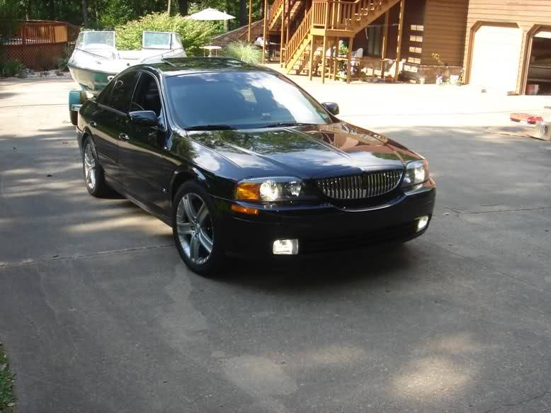

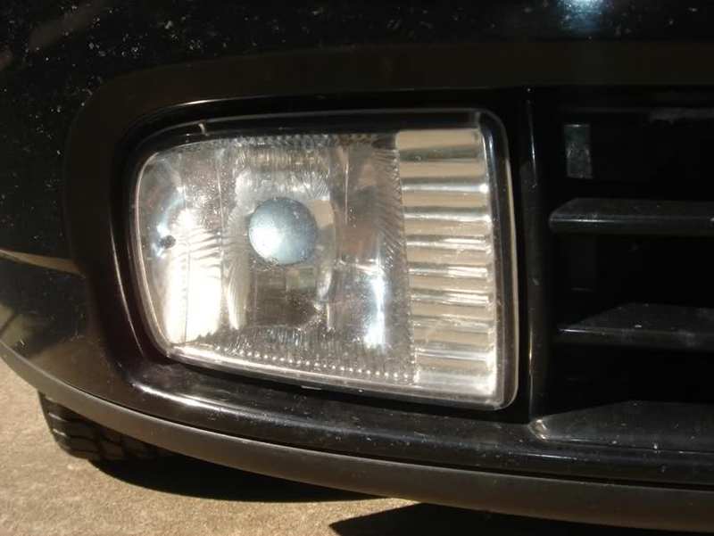

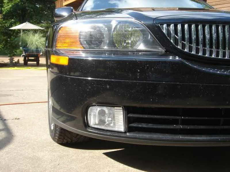

I still have not found the pictures of the work in progress!!!:confused: Here are some daytime shots. The entire 350z projector is behind the foglight and I just cut out a circular hole for the projector lens to stick through.
More pics to follow when I find them. Especially pictures of the back of them;)

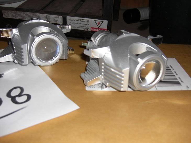

Nice work. These are the older-style 350z single-xenon "proflectors" (not a true projector, but a combination of projector and reflector), right? Looking something like this:
(image borrowed from this HiDPlanet.com thread)
haha that is a great name...proflector!:D Yes that is exactly what I used since I had them laying around the house. I cut off the side fins on the proflectors and then sealed the reflector part. The only light coming through the foglight housing is from the proflector lens:D

One more question, why did you not remove the amber reflector when you had those headlights apart?
Maybe because the "cleared" look isn't for everybody? :confused: I had mine apart and chose to leave the amber lens in because I wanted the headlights to be somewhat stock-looking.

That looks damn good. I wish the stock lighting wasn't so horrible. I get the same amount from my lows and fogs as you do from those fogs.
Yeah the cleared look is not for me. I like the amber lens actually.
Yup, not for everyone and I sort of smoked my ambers instead of doing smoked clear.
