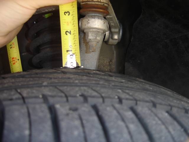

I wanted to do 22's as some have but I was looking at the clearence in the front. It looks like I cant do it...:confused:
Here's why, the stock tires are 235/50/17 at 26.25" overall diameter, and the 245/30/22 at 27.75" overall diameter. Which means I need .75", 3/4" from the center which I have 7/8" too close for my comfort. Does anyone have 22's on an 06 or pics of the front suspesion of an 04-05? I just want to see if pre-06 2nd gen has different setup than 06.

The stud sits an inch over the tread and dont want the wheels to stick out if I use spacers. If this is just an 06 problem then I will have to go 20's and be like everyone else. I just like to push to the max and be different. My aveo had 18's, one of only 2 people known to do it. Eveyone said 17's were the max, I knew better.
The suspension is the same on all 00-06 LSs. With 22s on 245/30/22 tires you should clear that bolt, but it's probably gonna be only very few MMs. You can shave the bolt off a bit for getting more clearance.
Lower offset wheels wont work especially with 22s, you will get huge rubbing.
When I had my 20s on with 245/35/20 tires that bolt was real close to the tire, probably like 6 mm, but never touched it as it moves with the wheel up and down.
