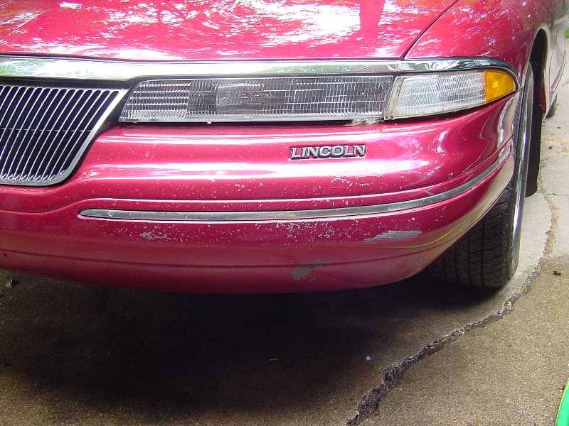

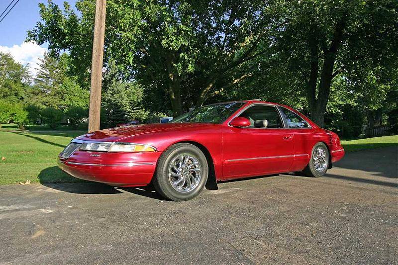

I repainted my red garnet glaze bumper. I bought the original tricoat paint. It was basecoat red, then a clear magenta color, then the clear coat.
I sanded the old paint off. My bumper had been repaired before, so I sanded all that paint off. Some little chips and imperfections, I filled with flexible spot putty made for plastic bumpers. Then I applied flexible primer, then the 3 coats of tricoat. I haven't wetsanded it yet, but it needs it, as the paint came out a bit orange peeled because it was too hot when I painted it.

Here's some before and after photos. It's not perfect, but it's my 192k mile winter car.
