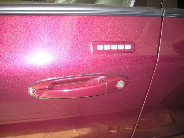

The Zephyr one won't work. I tried it. In the end I just painted the surround. I taped off the buttons and the car and sprayed away with paint I got from paintscratch.com.
Actually it's Dark Cherry. It's the flash and the angle that makes it look pink.
owlman said:
Did you do primer and clear also or just clear or neither?
I just cleaned it up real well, painted it and cleared it. I should have done more prep work like primer, but I was just experimenting. It doesn't look too bad so I just left it.
