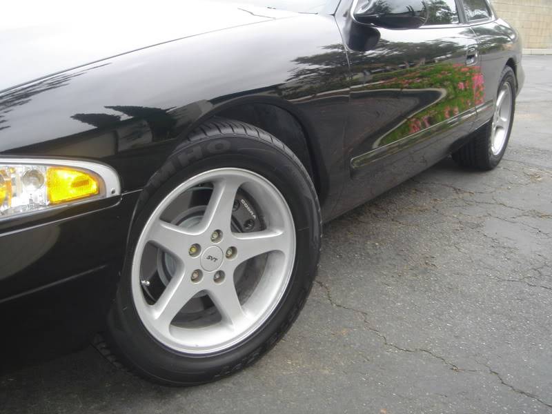

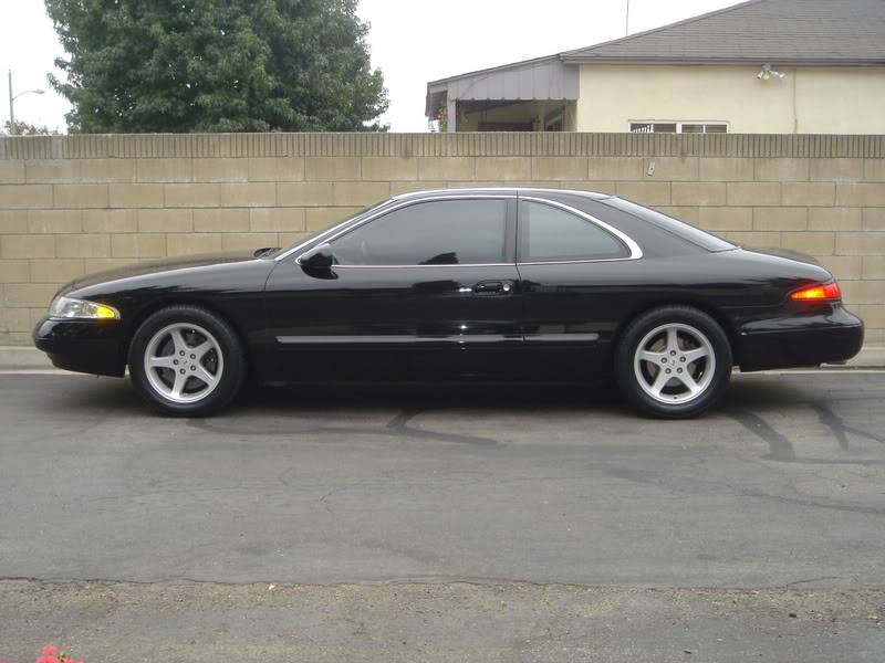

These are my 255/50/17
A 225/55/16 would probably be OK on a lowered car.. I run stock ride height with 255/50/16s, which are .6" smaller in diameter, they look too small for the car in my view...
