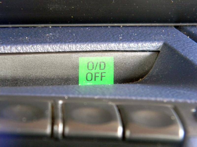

Dumb me I found myself playing with the OD button in the car and I broke it :(
Where can I get one besides the dealer. They want $45 plus $10 shipping.

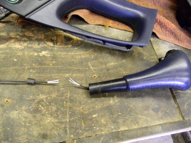

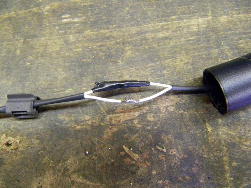

Are you sure it's the button and not the wire where most fail?
I guess it could be but that would be very coincidental for me pulling the button apart and it braking the wire.
