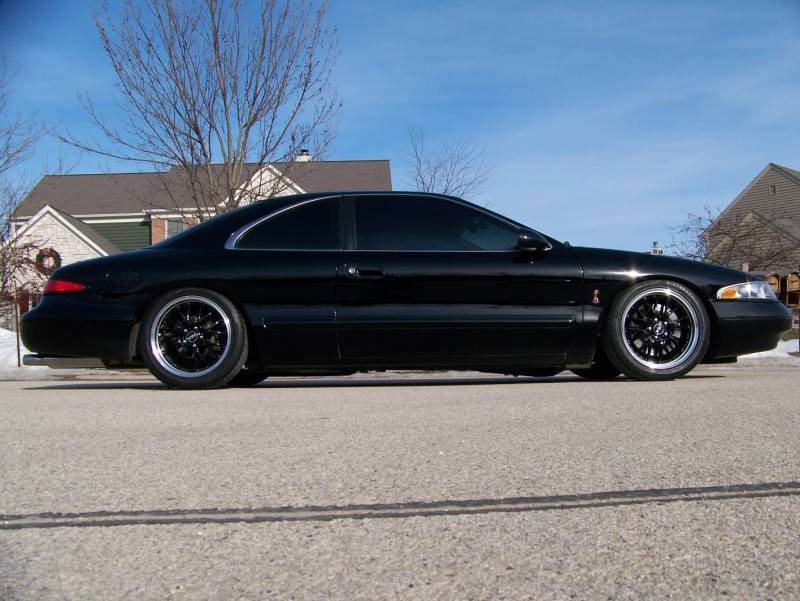

Well it was 50 degrees outside yesterday. 1st time in 4 frikkin months. Man, long winter. Had to take him out and clean him up a bit.

No, it's my new car.![]()
What you runnin as far as engine?
now you can be the MonsterMark:waving:
No crap. The '93 project car has been in and out of the garage for 5 years now.I'm great at taking them apart, just not so good at putting them back together again. At least this one rolls under it's own power.

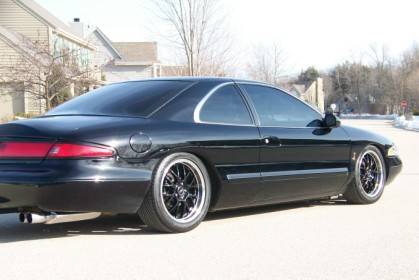

Mark motor w/ stroker crank yielding 298 cu in.
Forged rods/pistons with turbo friendly compression.![]()
Turbo speccams (.471 lift), ported intake/exhaust on the heads.
Cobra upper/lower intake with SCT Mega Meter.
72lb/hr. RC injectors with Aeromotive Cobra fuel rails.
Kooks headers going thru a double X.
