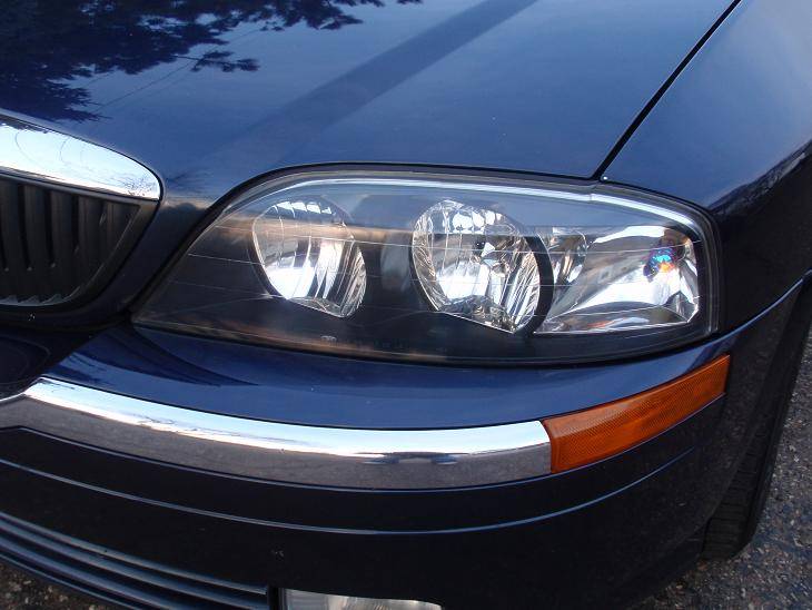

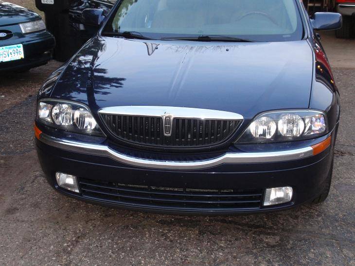

Thank you to all that helped out with my questions. I got them done on saturday. Looks awesome! Makes me wish I did that sooner. I took out the amber lens, painted the bezel, and sanded down and polished the headlight lens. Thanks again for the help. Heres a couple pics. It was cloudy out, so it's tough to tell the bezels are painted, but they are and look great :).
Hey Nic, that looks really good man, nice job. If you even want a crisper look I just got done installing chromium bulbs in the turn signals. They still shine amber but are chrome and blend in nicely.
Thanks. I got the sylvania silverstar bulbs. Are those different than the chromium bulbs? I didn't see any other options besides the amber bulbs.
Looks good, definitly a cheap and easy way to add a clean look. I agree that the chrome bulbs look really nice in the turn signal. Now you just need to clean up the side markers, tint them out or wait on clear corners.
Yae search eBay 3157 chrome bulbs and you will see what I mean. I had the Sylvania ones which were super bright but I wanted the entire front to blend in. They still light up amber but look chrome. I saw a blue LS like yours in St. Paul the other week looked good.

looks good, is your car blue or black? hard to tell on this monitor. what did you use to paint the bezel?

Thanks. My color is a dark metallic blue. To paint the bezels I got some ford motor company spray paint from welle auto parts. $5 for a little 8oz can, still have plenty left over too, even after 4 coats each.
