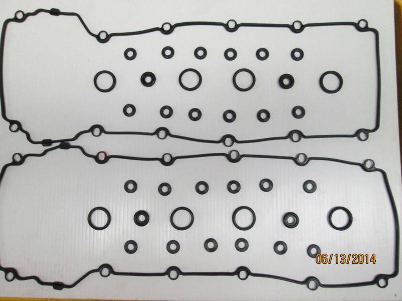

Valve cover outers may not be leaking but the inside O ring well seals would be in this case.
Be sure to order the entire VC gasket kit as there are also cover seal washers and spark plug seals needed in order to solve this problem.
http://www.christophersforeigncarparts.com/lincoln-ls-v8-39l-valve-cover-gasket-set2000-2006-sd0132
