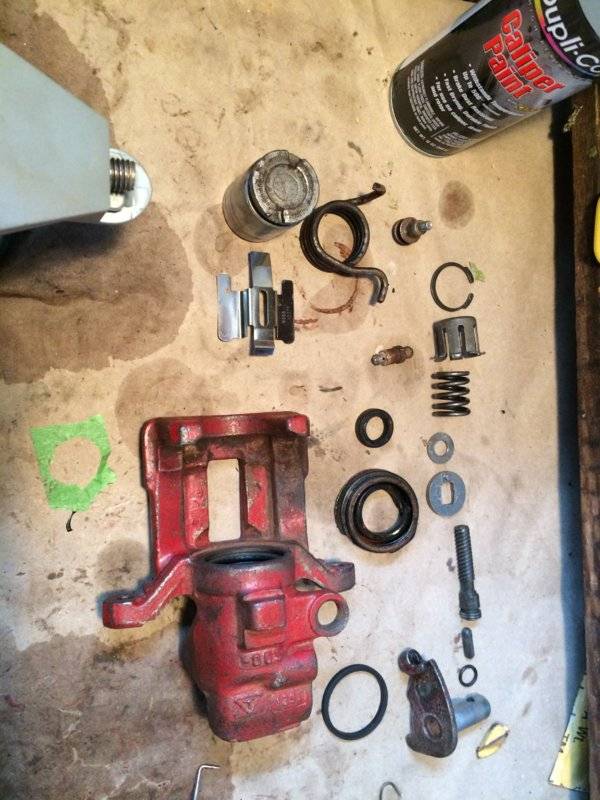

If I could dismantle them myself and fix I would but not sure if that would be as good as a rebuilt pair..
