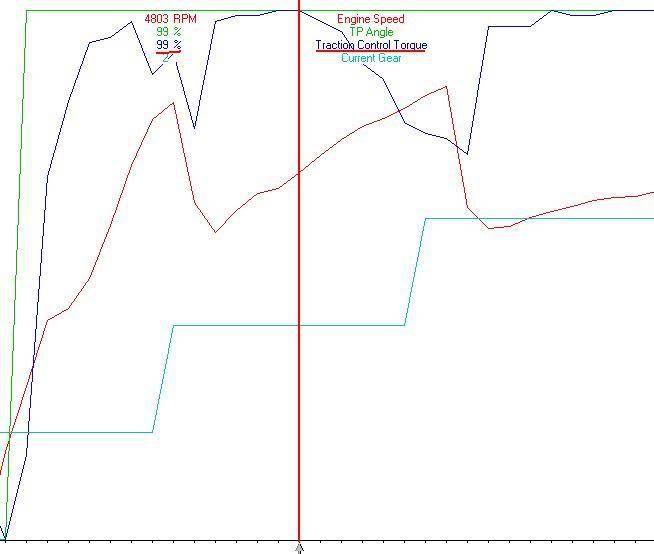

The 98 and 99 Seville program
I have cranked up the speedlimiter, increased the torque management up to 99%, increased the torque out put on low RPM's,
The 00 to 03 Northstar
I have done some major tuning
Speedlimiter moved to 155mph, Moved the shift point just a little higher, corrected some shifting problems, knocked a second or more off in the quarter mile. I have a little more on the stage one program to do and then I will move into the second phase.
