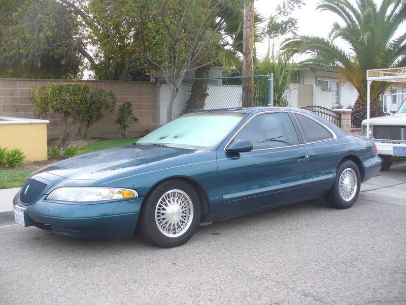

Here's a picture I took this morning still with dew on it and the front end kneeling.
Never seen those wheels on a gen two. Looks like bad air bags. Now leaning more to tranny connection then. Nice color choose.
