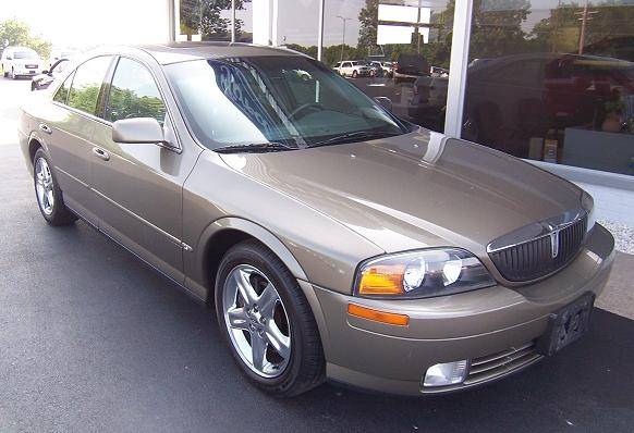

Hello, I am a proud new owner of an '01 LS. I am new to Lincoln, but certainly not new to wrenching in general.
I've been going through old posts here trying to educate myself. Something I decided to do tonight was to check for leaking valve covers. I started taking off one of the plug covers and didn't get very far. One of the bolts just turns, as if their is an insert in the valve cover spinning. Anyone ever have this happen? I'm hoping I don't have to break the screw head off (don't want to have to explain to the wife why I am beating on the car already).
I would appreciate any help.
Joe
