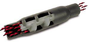

The moroso spiral flows have been my favorite muffler for a long time. i had them on my camaro pace setter long tube headers with 3" collectors, off road y pipe, and SLP loudmouth exhaust with a moroso spiral flow put in place of the SLP resonator...
http://s137.photobucket.com/albums/q204/trilkb/?action=view&current=Picture.flv
Those Revs were only to 4000 at most. That exhaust was great. no pops, no raspyness. smoothest loudest deepest exhaust ive hear. so i stick with the moroso's and at 50-60$ a pop why not?!?
Can you give a bit more info on how you have them set up on the LS as far as other components and all go?
there 2.5"
cut the stock mufflers off, got Car-X to put the new ones on in place of the old. with some turn downs. they had to make a adaptor to go from 2.0" to 2.5". if i were to do it again id try to place the muffler closer to the engine or try to get more pipe at the exit to get everything flowing the right way. since there small it might be possible to mount them under the car by the resonator and then get straight pipes where the stock mufflers used to be. or even get them to bend some 2.5" piping from there on back and open it up a little more.
51.99$ on jegs for 2.5" I/O high grade steel
99.99$ for 2.5" Stainless steal
