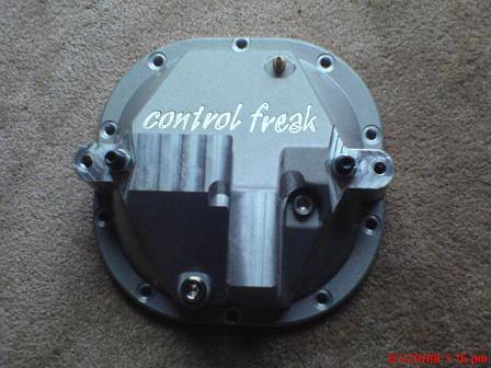

Another addition to the car (it was fun to install as the exhaust hanger is right were the left girdle bolt is!):
It's for the IRS, Atomic Performance sells them, good guys to deal with.
It is a direct bolt on, but I did run into one small problem.
The exhaust hanger on my car is right were the drivers side foot-bolt is, so I had to bend it into a curve to clear it which was a lil fun, but it installed good other wise.
Getting the upper sub-frame bolts off that hold the rear diff mount on the car was a bit of a challenge, but air tools took care of that, and I put anti-seize on there so it will come off easy next time if need be :)
It's great to have a drain and fill plug now too!
It's a damn shame that you can't see the cover very well once installed as it looks great :D
