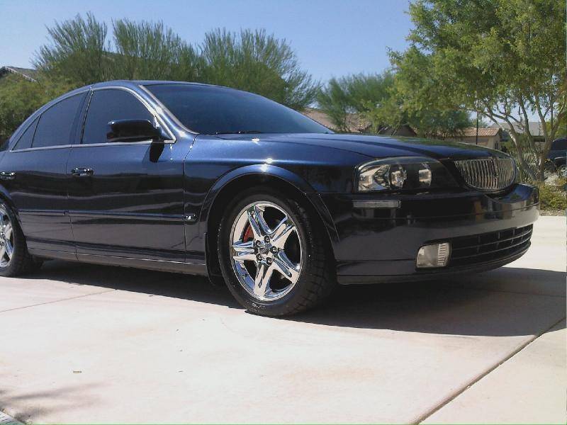

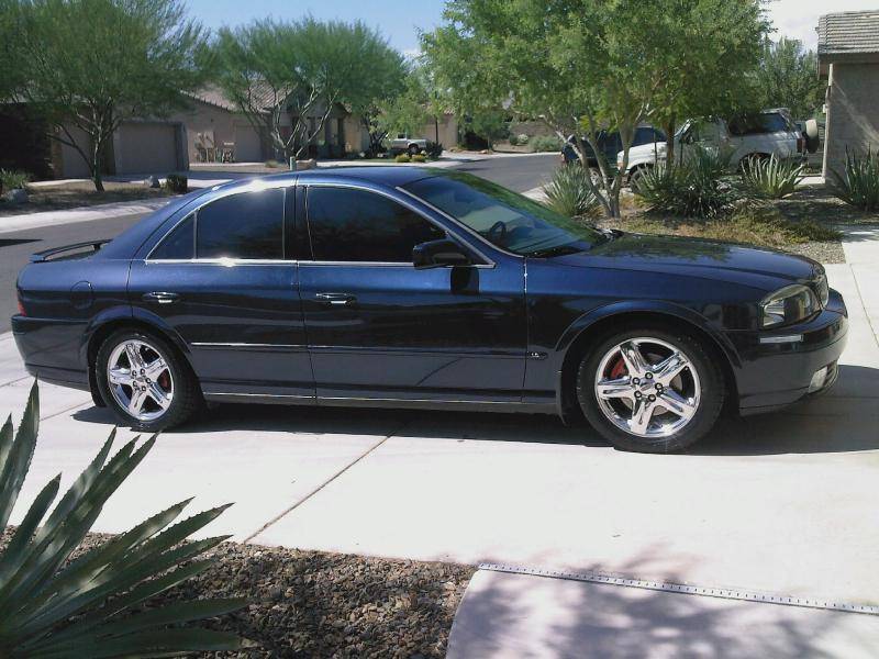

I just got new tires installed: Nitto NT555 Extreme Performance ZR 255/45/17.
I took these pictures before checking tire pressure.

Looks sharp btw..
