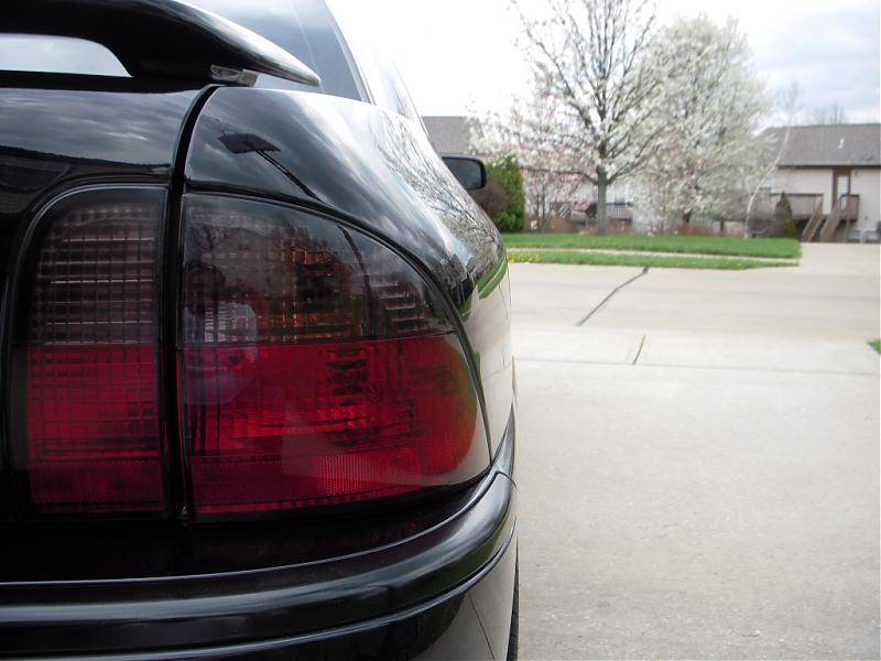

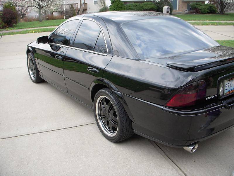

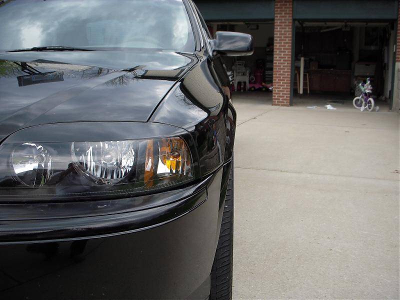

hey i just painted the rear surround, chrome corners and the mclaren grill let me know what you guys think
howed you paint the chrome bumper pieces? I took it to 3 shops all said it would be pointless to paint them.
i took them off sanded them real good two coats of flexible primer then three coats of base then three coats of clear been done for a week and still looks good

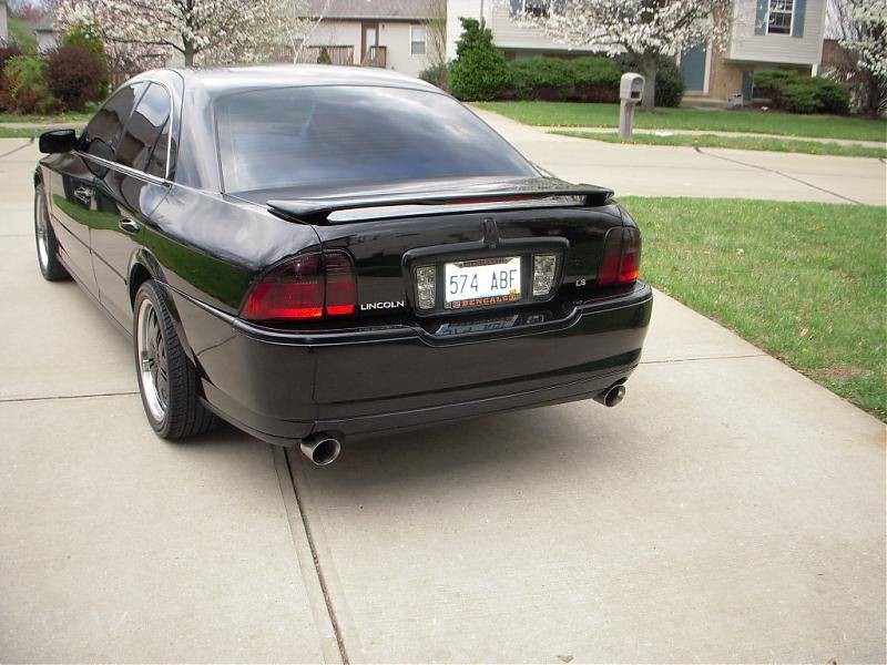

Nice and clean! I see you don't have the emblems on the front or back. Did you paint over them or take them off? If you aren't going to run those then IMHO you should debadge the rest of the car by taking off the "LINCOLN" and "LS" badges. Super clean!
hey thanks guys and i crack the front emblem so thats why they are both off and i not sure what i going to do yet with them if i want black or red so thats why there off. plus on the lincoln and ls badges on the back im not sure what im going to do with them i have a couple ideas that im thinking about

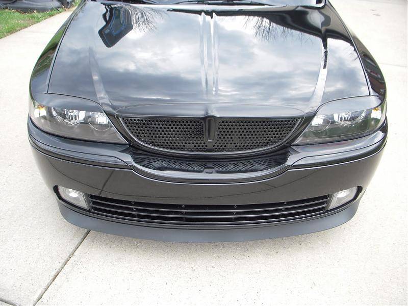

That grille turned out nice!:D

I got a great idea for those rear letters! How about taking them off and then placing them in a trash can!?;)
j all i really did was sand it then primer then base then clear it turn out great thanks for the grill again
