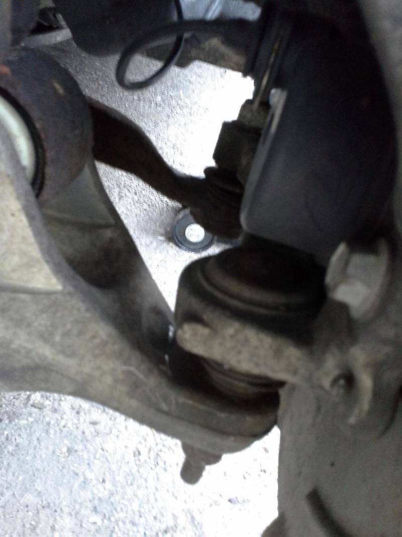

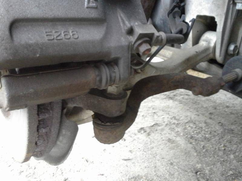

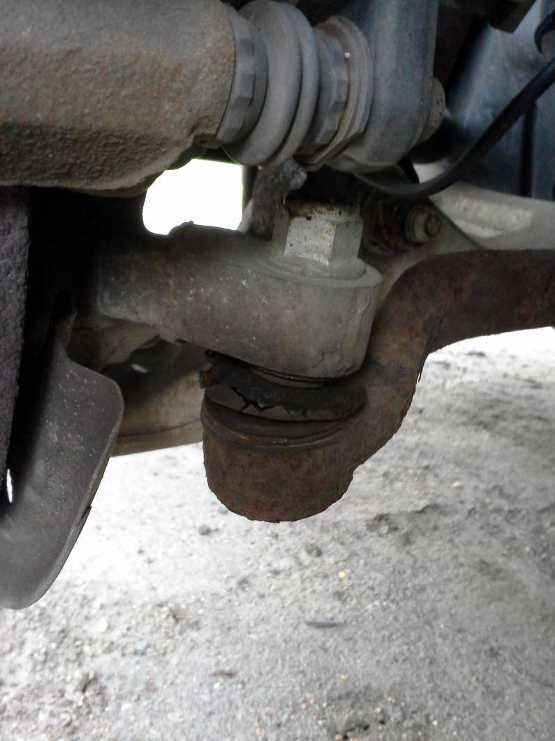

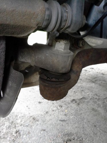

One, the car wanders (or drifts) while driving, mostly at higher 40+ speeds. Her mechanic said she needed new ball joints, so I was expecting that. After getting the car off the ground, I pulled on the wheels without any give, except for possibly the bottom of the driver's side (so, possibly lower ball joint). I expected much more play in the joint (and may be imagining the tiny bit that exists). The tie rod end is visibly bad (see attached pics of tie and joint). Is it likely to just be the tie rod, or should I go through the pain of both replacements?

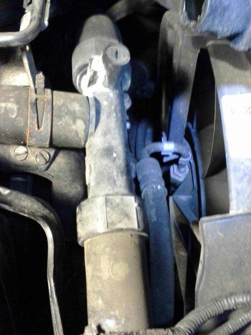

Two, the car has a large engine coolant leak. A half-gallon to gallon must be replaced every day (clearly, it is currently parked). I cannot see the source after light inspection, and neither could my mother's mechanic. It seems to be coming from the rear area of the engine. Is there a likely common culprit there that I should seek out?

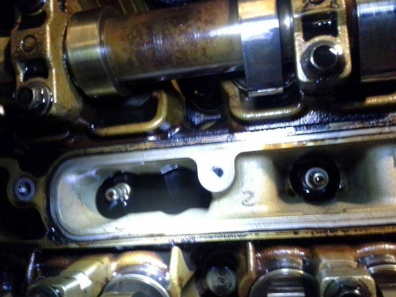

Three, the engine is throwing a number of frightening codes (P0171: System too Lean (Bank 1), P0174: System too Lean (Bank 2), P0303: Cylinder 3 Misfire Detected, P0304: Cylinder 4 Misfire Detected). I left out an overheating code that is likely from the coolant leak. Any ideas on these? Could they be related to running on 87 petrol for the last 5+ years?

Close-up of ball joint (pics really don't help from what I understand, but figured I'd put one up anyway)

Tie rod end close up
Tie rod end overall

1.your leak is the degas bottle (overflow tank) replace it with a OEM from the dealer don't get aftermarket.
2.you need to replace the coils and spark plugs. we recommend doing them all at the same time and while your at it check for leaking valve covers. don't get the ebay ones most of them fail fast, so you have 2 options OEM (BEST ONES) or the bwd (advance autoports) ones. the only reason I say to get the BWD ones if your not getting the OEM is that they give you a 3 year warranty so if they fail just replace them for free.
3. the ball joints it all depends if you mechanic can press them then get these from ebay.
http://www.ebay.com/itm/Jaguar-S-Ty...:Lincoln|Model:LS&hash=item3f17df48aa&vxp=mtr
if he cant press them then you need to get the full assembly that comes with the control arm.
http://www.ebay.com/itm/LINCOLN-LS-...:Lincoln|Model:LS&hash=item5d2d1a0d10&vxp=mtr
You can get the Visteon coils on ebay. They were a Motorcraft supplier and many of us have had good luck with them. Your codes will probably go away after that.
Ahhh, No!
Maybe for the V6 but you'll not find Visteon coils for the 8 on eBay.
It is the 6. My father wanted the 8, but for whatever reason decided not to. I wish he had, looking at the work needed to get at the coils and plugs in the 6.

The aftermarket bottles are Dorman bottles, and are not made well. Some members here have had failures right out of the box, others have had them crack again within 6 months and had to do the job again. OEM should last as long as the first one did.

Even with the V6 you'll be hard pressed to find Visteon coils for it on eBay as well, Visteon stopped making coils for the LS and it's inventories have been depleted. OEM Motorcraft coils is the best option. Any aftermarket coil out there for the LS is going to be a gamble.
The threads for the pressure cap are of a weak design. (at least that's what I read, never own a Dorman myself)

Wow. That is A LOT of oil!
A coolant hose was rotted through, and popped right off while working on the intake manifold.
Looks like I have another thing to add to my salvage yard list.
Ohh yeah, almost all the plastic cooling system components are probably going to go. It's another common thing on LS'. If you have the cash to do them now might save yourself the head-ache later. If not I would plan on it. Is there a hose that runs under the manifold like on the V8 that needs to be replaced on the V6? If so I would say go ahead and replace that while you got the manifold off.
