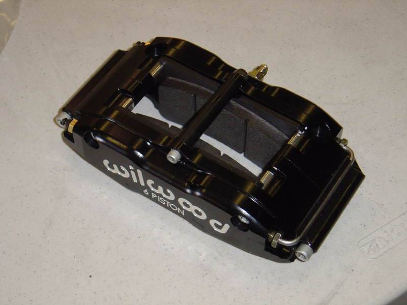

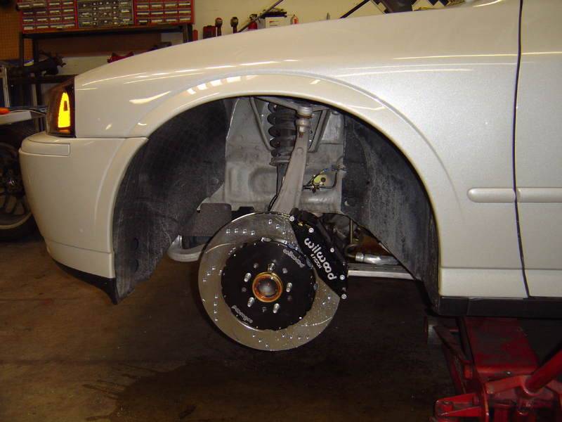

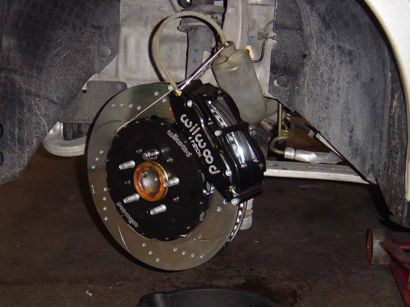

I will apologize in advance for no road experience opinions because this just made it to my garage onto my car today. The 30 min drive home was perfect, I forsee some pretty fun driving ahead. These are 14" vented, cross drilled, slotted rotors and 6 pot Wilwood calipers on my 2005 LS....
My thanks to Todd at TCE Performance products for this first fitment to an LS.

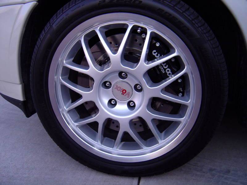

what size rims are those? they look good.. jus not much bigger.. whats the price range on these?

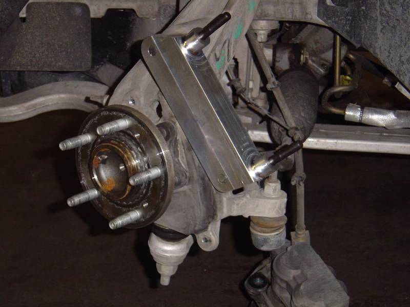

Kit was less than the price I've seen for the Stop tech kit, and price meaning installed on the car including tax. I don't quote it now out of respect for the fact that it was the first Todd TCE had done, and he did me a reasonable deal since it was a development project. I am certain he did up an extra set of adapters or two for any future LS deals.....check with him to verify that.
At this point I'm afraid that series of pics is all I have. The offset of the 18's I am told, is somewhat more than average and the clearance is not much more than the wheel weights will allow, in other words it's close. Some 18's may not work.

At this point the kit is a "one off" but can be reproduced. It does include front SS hoses. Pricing cannot be stated for Forum rules. Very easy bolt on package, future brackets when produced will be black anodized as well to match the hat.

Those brakes sure look purty!! What offset and wheel size would be needed to clear the calipers?

I'm sorry but I have dive on that one, I constantly found myself going faster than I should (after driving a Focus SVT as a daily driver) for the responsiveness/effectiveness of the stock brakes, they did not bring the car down fast enough and there was a delay in response compared to the Focus' responsiveness. I knew if I wanted to really use the LS's handling and power in the future, I needed to improve the brakes. I have confidence the master cyl will be fine, they feel the same as standard in regular driving conditions, the pressure vs braking response feels the same as stock. Until I get a chance to drive them in anger, I don't fully know but I have no suspicions about the performance of the standard master cylinder.

Oh, and for a question asked by LS4me, I'll get a look at one of my rims, and let you know the offset....

BTW, the fronts have around 10K on them now and are brilliant. No issues with the stock hydraulics and the basic feel (pedal pressure) is as stock. They don't give me that scary feeling from higher speeds as the stock ones did. Part of that scary feeling is because of what I expect brakes to feel like after driving my SVT Focus. Now they inspire confidence. All we did was upgrade the pads to BP20's along the road of development and we're settled in to a very nice package. Just need to complete the rears now.
