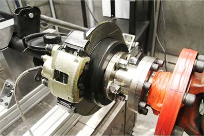

Happens on brake dyno when the cover is removed. Some people just love to smell ammonia and formaldehyde.
One skinny little letter ......
Yes, I don't proofread.
Used to. These is a pass car sized dyno. What was really neat were the commercial vehcile sized dynos and the two railroad brake dynos. But I preferred being in the vehicle test side.
