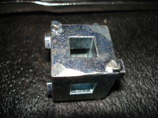

Do you have a 24/7 auto zone or checker nearby? The wharehouses here in PHX are open all the time and they may have a cheapy tool that may get you going. As a last resort, try the business end of a pair of needle nose pliers and try not to stab yourself in the hand to much. Push down hard and turn.
You could also use a pair of channel locks. I've read this in a post. You need to push back the rubber seal to keep it safe. Then grip the piston around the metal edge and twist it clock-wise to make it go back in. Remember to open the the brake fluid reservoir lid. AutoZone sells an $8 tool to do this job, but you'll have to file the pegs in order to make it work. You use a short extention and a 3/8 inch ratchet with it.

It's nice to have, but not necessary.
Bolt the caliper back on without the rotor on the hub, then use long-nose pliers to rotate the piston.
Autozone's doesn't fit, like you said you had to file the pegs.......
But, Oreilley's cube tool fits perfect.
Looks the same, but isn't.
