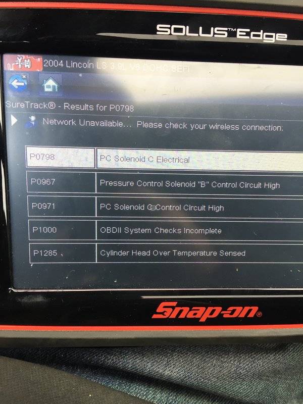

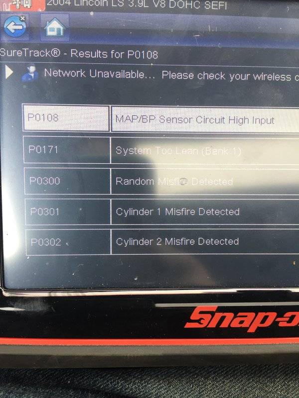

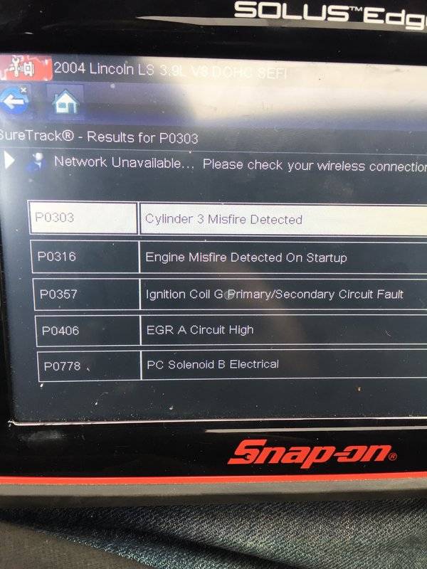

Good morning world. I need a little help. I did a lite tune up. Plugs a new coil and a filter. Just to get rid of the misfire. After that's done start the car let it run. The check engine light comes back on and it's still missing. Have these codes now. Any clue how to get rid of them or even what they mean?
A few of them I get. But the others. I'm stuck on. I need to fix this and not kill myself on parts. I'll be doing most of the work myself. Any help or suggestions would be greatly appreciated. It's getting too nice up here in Philly for my car to be down.
well then there is a very good chance that the reason (or at least part of the reason) you are still getting misfire codes are because of the other 7 coils.
