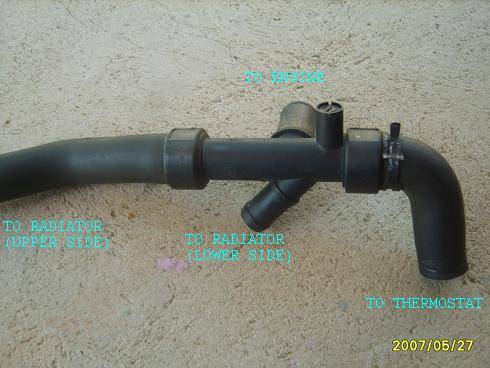

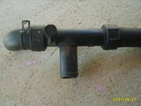

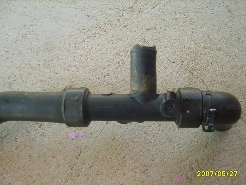

As you all know my car recently overheated, Cracked degas bottle, and now this hose is literaly falling apart, and need to replace it. Im not sure what is called, so im asking here if anyone could help me out with this part (LOCATED UNDER THE INTAKE TUBE).. There is a number (# YW43-8B502-AA) on the hose that I believe is the part number, but came up empty handed when searching on fastpartsnetwork or teamfordpartsonline. Any help would greatly be appreciated, THANKS.
LS v-6 3.0
Should be a coolant crossover tube.

Need more help...
I have the same problem as lexdiamondz10304. Unfortunately, the motorcraft part #KM4710 that I received from rock auto doesn't even resemble the one that lex pictured above.
Does anyone know more about this product?

I don't knwo the name of the part, but one of the small plastic pipes that flows the coolant through it, broke on me when i was removing it.
