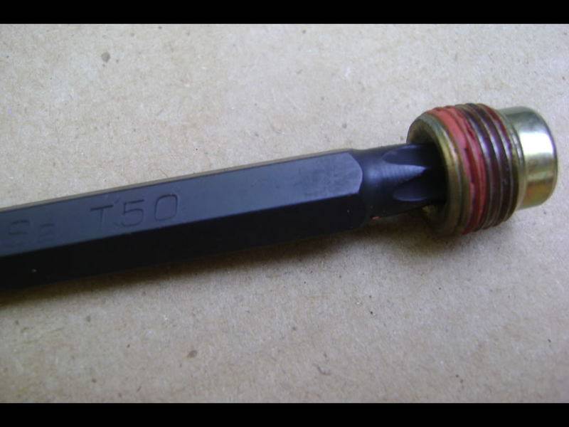

Alright, yeah, I found the bolt and have the pump and Mercon V, but I can't for the life of me loosen that dang bolt. It's in a really confined space. I have a long allen wrench that I'm using in conjunction with some vice grips, but I just can't get any damned leverage. Is there a better tool I could use?
Thanks for the help.
I'm thinking a socket would be the most practical.
Is this the size of the it would be? T50?
I just wanted to let you guys know that I had to get an allen socket to make the fill cap budge, but I was just glad I got that over with. Either way, it's all good now. Thanks for the info again, drag. It was a good reference for double checking the steps.
No problem. Thanks for the follow-up.
Is that a Torx socket plug? Looks like it since there is a Torx 50 wrench in it. But sometimes you can cheat and use an Allen in a Torx and vice versa, but not good for either in the long run
Anyway, Most tool sellers will have some Torx and Allen 3/8 and 1/4 inch drive sockets which you can use on a ratchet. Or even small breaker bars if you need a bit more clearance. I have a set of these and they make tight spots much easier to work on rather than trying to use my regular or allen wrenches.
