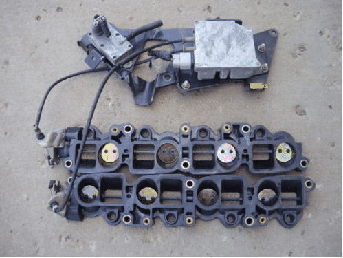

Gen 1 B head intake manifold side
Gen 2 B head intake manifold side
Gen 1 and gen 2 B heads use the same pattern on the cylinder head side.

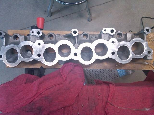

Conti's (with the C heads and B intakes) use an adapter that uses a gen 1 B head pattern for the intake manifold side with a C head pattern on the cylinder head side.
first gen intakes, and conti intakes have 2 circular ports. therefore, conti adapter works with the circular port intakes. (first gen mark)
see 2 circles.

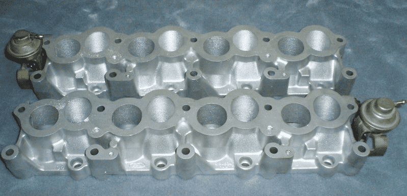

now, 2nd gen and cobra intakes have 1 circle, and 1 square hole.
therefore, you can not bolt the intakes with the square holes to the adapters with circular holes. only intakes with 1 circle, 1 square. (2nd gen, cobra)
they look the same on the bottom.
1 circle, 1 square.
Can you rotate any ONE of those pics from your last post? I want to see IMRC's from both years going the same way.
Early cobra IMRC's 1997 are alum. I would get these and the conti adapters cut both in half and weld cobra upper to conti lower. Hows that sound? I could be on something here! Or make a billet set like MMR billet delete plates.

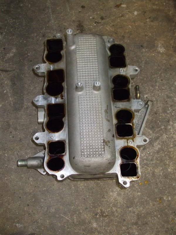

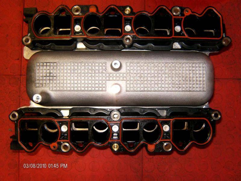

What we need to see is the ports on a gen2 intake or a cobra for that matter. I know it combines the split ports some how.
The bottom of my cobra intake looks just like those black plastic IMRC's. Does not combine the round and square port.
Well the cobra intake combines the ports in the runner up in the intake. You could build an adapeter no doubt. But the only problem would be getting the injector bungs perfect.
Well the thing to do is just make the cobra top fit a c head lower. I have seen that done. And would be alot easier.
