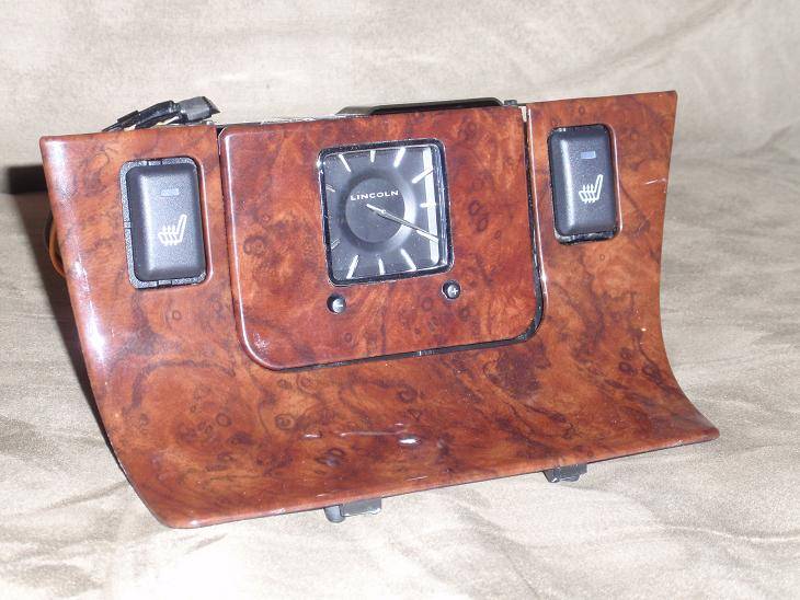

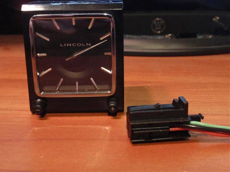

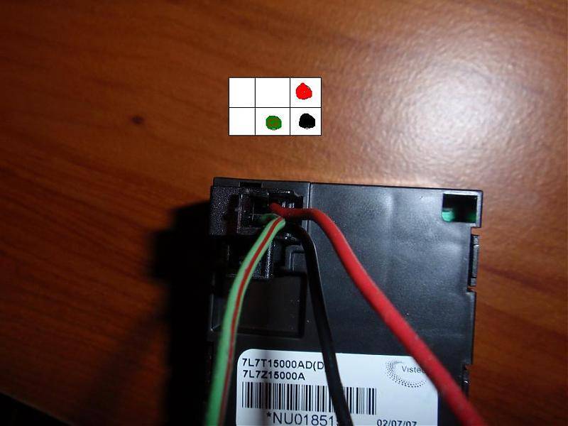

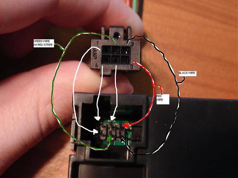

Hey everybody. I have a Lincoln LS that I retro-fitted a 07 Navigator clock in. The hard work is done, now I just need to wire it. Problem is, the clock wiring connector I got out of the junkyard out of a Mercury clock fits, but apparently does not make the clock work. Does anyone have a wiring diagram that shows the connector for the clock? Or could someone be totally awesome and take a quick picture of the clock connector so I can see what wires are needed and where? Please? This project is almost done, I really want to get it installed. The pics show what I have done and some pics of the connector I currently have.
haha, i like your photoshopped wires in the third pic
cant help you with your question though. best of luck. it looks good so far.
Thanks. It was done using microsoft paint. That program sucks, but it's all I got.

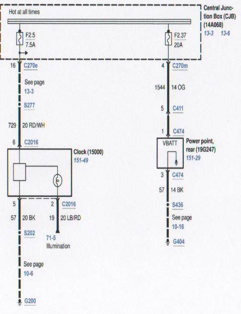

hold please searching.............. wow that was a PIA its listed under horn/cigarette lighter, then my puter wouldnt let me save the pic, so i printed, scanned then up loaded, looks pretty easy, did the clock work?
this is for a 03 navi
