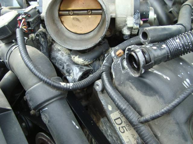

Looked fine a week or so ago. Stopped at WalMart on the way home this morning for some windshield washer fluid and some 22lr. No 22lr but found this when I popped the hood...

No, the plastic cooling system parts at the front of the engine are leaking.

Yeah, Joe's kinda right. It had a tiny crack that you can't even see on the front edge. Held water, actually hasn't used any in a long time. The white stuff is almost like foam.
Ended up getting a new MC one made in the UK at the local Ford dealer for $80 OTD. I wasn't waiting 2 weeks for UPS to do a ground delivery and Tasca wouldn't FedEx it. Took about an hour to swap out and am currently letting it burp itself.
