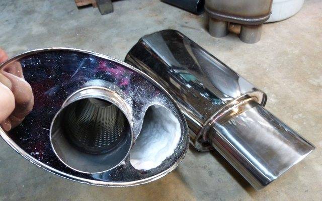

Thanks for your consolation on my resent grief CF... Being only 5 years in TN now, its a live & learn thing on the shops. I have a great mechanical shop but they didn't want to get involved with the valve body work. Seems the trans shop let the exhaust pipe lay right on the rear cross member or forgot to tighten it up good enough. Any way it helped me to finally make time to plan on cutting out the single exhaust and put in the 2.5 SS duals. I bought the truebenz starter and added a bunch of pipes and straight threw mufflers. The rear cans pictured are very nice and match the cut in the rear bumper but they were hollow so I'm stuffing them with glass matt and yet to mig weild them shut. The X muffler (in back ground) is same perforated straight threw but again, needs to be stuffed with glass. The 3rd muffler is stuffed with a steel wool type stuff. I'm hoping for zero noise at cruzing speed. Hoping to not have to matt wall the trunk....but will have to see how this all works out. I'm not fond of working under the car on my back with these darn bifocals but that's how I KNOW I will get it done right the first time threw. Can't trust those kids you had mentioned out there.

I too went the truebenz route to dual exhaust. just for the sheer joy of it I ran sans mufflers for about two months. very loud. loved it. then put on some magnaflow. skipped the resonators. no drone to my old ears on the highway.

by the way, I joined the two pipes together at the point they pass next to fuel tank and added an heat shield to the tank. can't hurt. were I to do it again, I would have gone with the 2 1/4" pipes because the 2.5" pipes get a little tight. this is a base model mark 8 and the basic objective was to get away from the awful single exhaust with the tee aft of the rear axle. flows much better.
