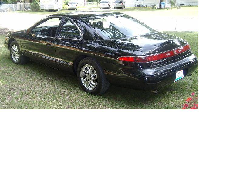

my 96
96 LSC. Best Mark VIII there is.
Only thing wrong w\ it is that the wheels are on backwards.
They're supposed to fan forward in attempt to look like its in motion even when parked. Half of mine are backward, which looks even worse, lol. Not tha your mark looks bad in the least.
they are definitely on backwards..
most common cause ... when you get your tires rotated they just switch sides with the whole wheel.. but since the rims are directional.. they shouldnt switch sides.. just move front to back and vice versa on each side...
or remove the tires themselves for rotation...which takes a lot longer
or if you got new tires... the shop may have just put them back on the wrong side not paying attention

See the clear coming off my bumpers? I have a few spots on the roof also, anyone in Florida good at blending those In?
You will need to sand those problem areas out, and repaint the entire panel. At least it is black and you wont have to blend the adjacent panels. Talk to Jamie, He does that kinda stuff all the time.
Heh, looks alot like mine, black on black, HIDs, clearcoat problems on the roof and rear bumper...
Yea had friday off spent most of the day on it. washed waxed whiped out the engine cleaned out the inside and armor alled the crap out of it looks really good like the pictures except the fading spots. dont have the 2k to have it painted just paid it off lol
