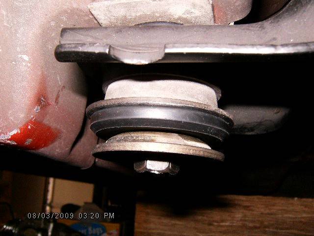

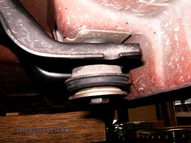

Mornin Gents: What are the names of these bushings?
Myco
Nov 28, 2008
913
8
Houston
[/IMG]
Doug, how did you press them out? What made them so difficult?
They don't press out, as the rubber is bonded to the shell which you have to keep. I cut out as much as I could and then used flap wheels on a drill to get the rest out. :eek:
Anything wrong with just burning them out? (asked Marcus because that's what he did) :)
BTW Myco, just to be clear, those bushings were never available from Ford separately. They came as part of the crossmember. Poly is the only alternative.
No, not that I can think of.
In that case, they're easy to get out! Just set them on fire with a blowtorch (thanks Beerdog) and they'll fall right out in a few minutes. :D
...well, assuming you're OK with repainting or powdercoating the crossmember. Otherwise go with DLFs way.
I forgot about that! Marc was all worried about killing the grass. I was like...its just grass, it will grow back. He is too kind.
