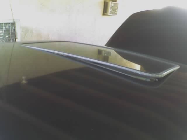

alright last night i was coming home from crusing around and my moon roof started making noise, i thought the motor had gotten loose like last time but no, checked it out this morning and motor was fine........but, moonroof will not open up and go inside the roof, it just gets stuck :( , i take the motor out and move it back manually to the closed position, align the motor, move it between vent and closed, and it works fine, i try to open it up it gets stuck, then it just binds up when i try to close it back up, and when i try to put it in vent, the right side sticks out, the left side of the glass doesnt go back up............... :confused: ...........

yeah the motor was hanging when i aligned it, i have a 4 day weekend coming up from work so ill have time to dig around and mess with it to see if anything broke inside of there, thanks guys
my roof is still not working right :( ........i cant see anything broken inside (from the little parts i can peek into), nothing sounds loose or anything, tried to time to motor many times now and no luck......... :mad: .......... im starting to think its the plastic Jibit mentioned, were is it at? can it be replaced?
also, service manual shows a ground cable going to the driver side screw on the moonroof motor, i cant find such cable :confused:
