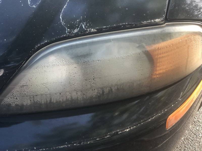

Has anyone had this problem with moisture inside the headlight housing? If so what was your solution? Wondering if I should remove the whole thing, take it apart, clean and buff it out for that crystal clear look and put it back in, completely replacement the whole light or try and find a place that does custom lights. (Ignore the horrible chipping paint job it needs a new one badly )

Make sure there's no cracks and that the bulbs are sealing correctly. Otherwise, it's pretty common on Gen 1. It used a rubber butyl sealer that softens with heat. It's usually fine if applied correctly. It may be possible to reseal it by putting it in the over for 10 minutes at 210F and then pressing it together. If it doesn't budge, try 5 increments. Remove the clear adjusters first! 1/8th turn and pull. Get it to room temp before removing those as the adjuster sockets can crack. Don't put it on the wire racks. Use a cookie tray. Don't put it too close to the heating element. Caulk or tape over the lens/housing seal is a poor but less risky alternative
Gen 2 has permaseal, which sets permanently. The above does not apply to them. They're usually pretty well sealed as long as nothing is left open

The o-rings on the bulbs usually last the life of the bulbs, so unless installed improperly, the housing seal is most likely bad.

If the bulb socket isn't messed up, and the o-ring on the bulb seals well... then the best thing to do is separate the halves of the light and re-seal with epoxy or butyl caulk... using the method FDR mentioned above.
